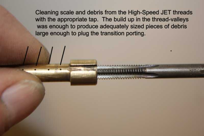

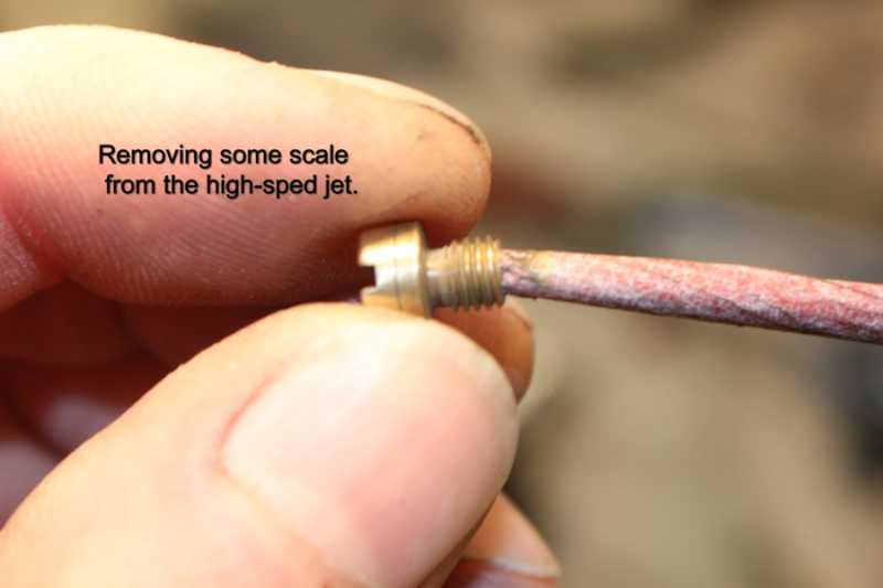

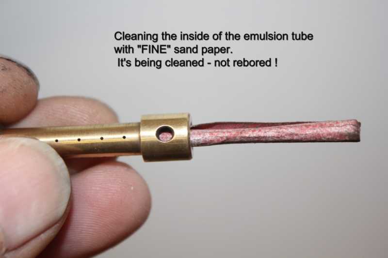

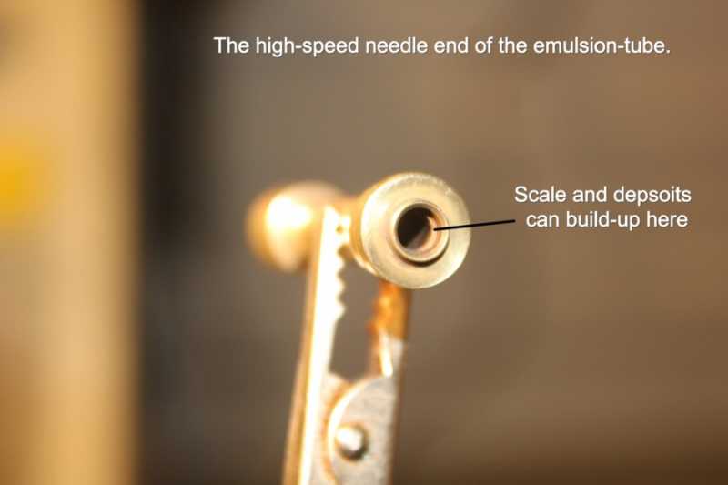

NOTE: The seals on the throttle shaft ends could be damaged if soaked excessively in strong cleaners such as lacquer-thinner. The use of lacquer-thinner for manual surface cleaning and gallery flushing using a syringe is OK.
The Tube-Cleaner is Nylon !
The Choke plunger Nut needs only to be "snugged" - NOT torqued !
Last edit: 10 months 2 weeks ago by scotch.
The following user(s) said Thank You: KZQ, PaulD
- Posts: 2067
- Thanks: 954
Re: 1979 carb. rebuild (Pt 3): The final steps
11 years 11 months ago - 10 months 2 weeks ago

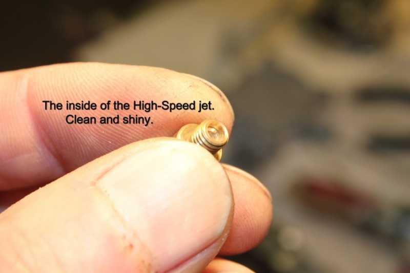

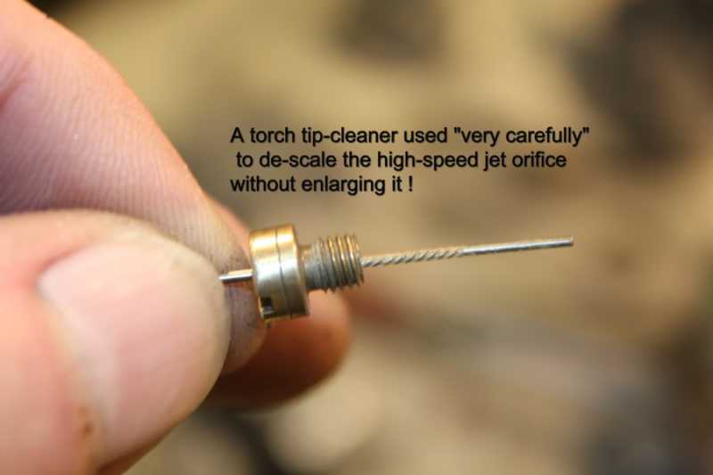

#1 NOTE: There are are number of internet articles regarding the very specific design and machining of fuel jets. These articles state very emphatically that when cleaning jets, attention be paid to not changing any shape to the entry and discharge-end bevels and steps that are specifically designed into the jet for optimum fuel dispersion. This includes the smoothness of the jet bore which is factory "reamed" for smoothness and perfect symmetry - not simply drilled. If in doubt - Replace !
#2 NOTE: The seals on the throttle shaft ends could be damaged if soaked excessively in strong cleaners such as lacquer-thinner. The use of lacquer-thinner for manual surface cleaning and gallery flushing using a syringe is OK.
