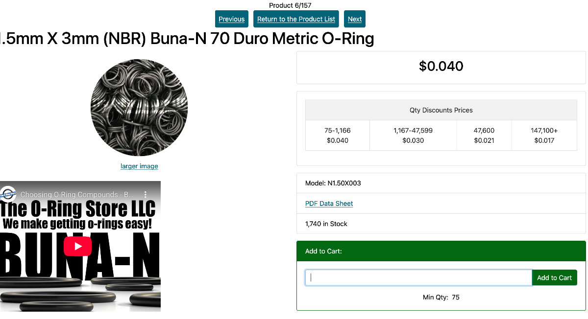

- Posts: 1308
- Thanks: 300
Re: Idle Jet O-Rings source?
8 months 3 weeks ago - 8 months 3 weeks ago
Well, the price is right!
Might have to buy a bunch more carb racks to use up 75 o-rings though? (min order)
