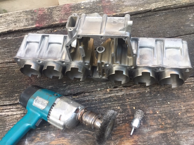

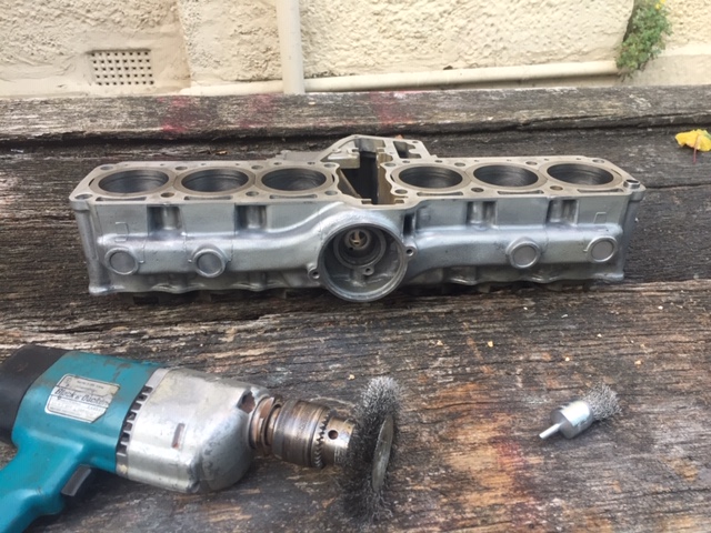

Update for today is that I have cleaned the jug with a few basic tools and am half way through masking it for paint (how does one get clean masking edges with curved sections?? I tried knifing the overhang with a Stanley knife, but still not a very clean cut).
I have also spray painted one cover as a test with Motip heat resistant paint, colour Dark Anthracite. I chose this as it can go directly on (sanded) aluminium and for curing can go into the oven for 60 mins at 160C. Having done that the paint still felt a bit soft, but more disappointingly, it was matt. So I covered it with some Simoniz clear lacquer (although not sure if that is heat resistant) to get some gloss. Hereunder a pic of the result. Looks OK - apart from the blemish in the middle where eager-fingers-here tried to feel if the paint was still wet (it was!)

Hi McBoney, just a word of caution from past experience. The Alt cover in the picture be very careful that you don't overtighten either of the two lower bolts at the bottom of the cover as there is no support directly behind the cover there you can easily crack the cover behind the bolt hole and end up with a oil leak. And you may think its the gasket by mistake.
Just my 2 cents worth
