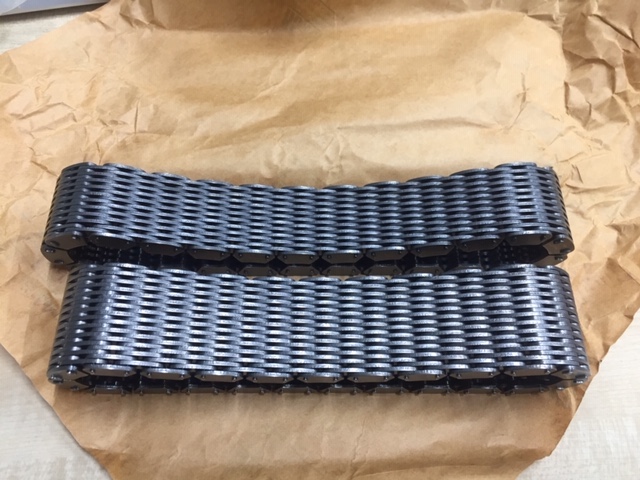

And hereunder what turned up this afternoon!

Great! The chains I have seem very solid when playing with them, but a real test will be when having them assembled.
