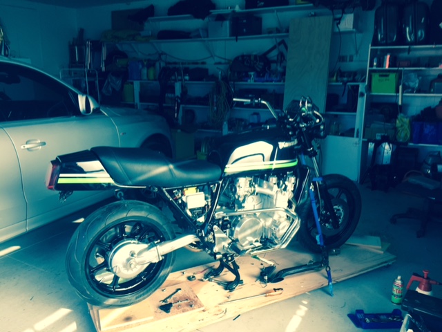

11 years 3 months ago - 11 years 3 months agoHelp i have now been trying to get my bike A! with A3 engine and the dodgy ignition everyone seems to hate running for 8 months had her running last week but the guy seems to think a wire shorted and may have damaged a transistor which is being replaced he also changed some wiring to the coils very frustrated and i am going to remove the bike from this guy being a carpenter builder electrics etc are not my forte but i am going to have find someone who is and really feel like i need to start again not bothered about expense really just want her running these are very complicated bikes i have just done a Z1B which i plugged together away she went so all said what i need is a list of where i get some one who knows what they are doing and ask them to go through the following checks which i would be grateful if someone could supply where i would start after 8 months going insane even starting to think the guy wants to tire me out with it so i say mate I'm over this you can keep it and walk away
