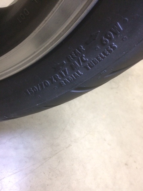

An answer to a P.M. question - This is what I'm rolling on:

Who makes it?
And how did you come up with this size? I know i am repeating myself, but looking at the data on the Tacoma tire size comparison calculator, size 80 seems to match better the original size. I might be missing something looking at this, these tire sizes give me always a headache and can't get myself to really study them.
