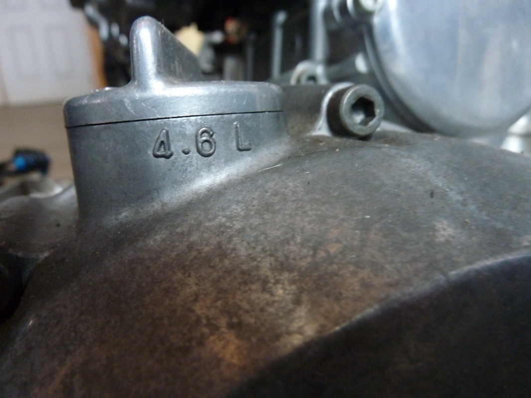

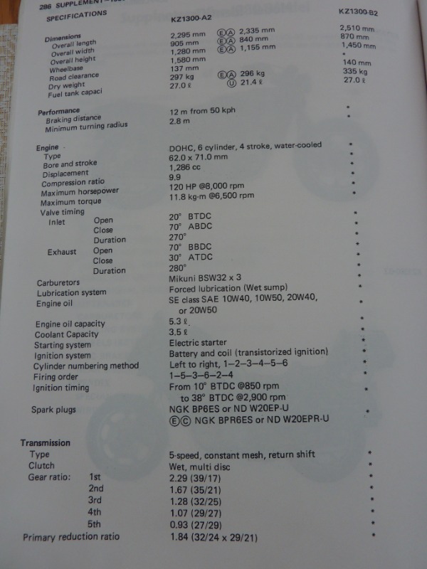

My observations and experience with the larger oil pan /sump.
They are very hard to find. We had this discussion about a 10 years ago and the first observation was , as Kawboy stated, concerned high oil consumption on the 1979- early 1980 models. The solution from Kawasaki was to add a larger oil volume - and fix the consumption problem . Some members thought the larger sump began showing up on bikes mid 1980. I have 3 workshop manuals.
The first was printed Jan.22 1979. On page 21 it states oil capacity with filter is 4.6 litres.
The second manual was printed Dec.14 1979 and it too states on page 21 the same 4.6 litres. But this manual also has a supplement added starting at page 283 covering the 1980 model and the changes that were made and on page 286 , the oil capacity now is 5.3 litres.
The third manual was printed in May 14, 1997 to cover models from 1979 to 1983. It too states on page 21 the same 4.6 litres with filter. But the supplements at the back of the manual then cover 1980,1981, and 1982.

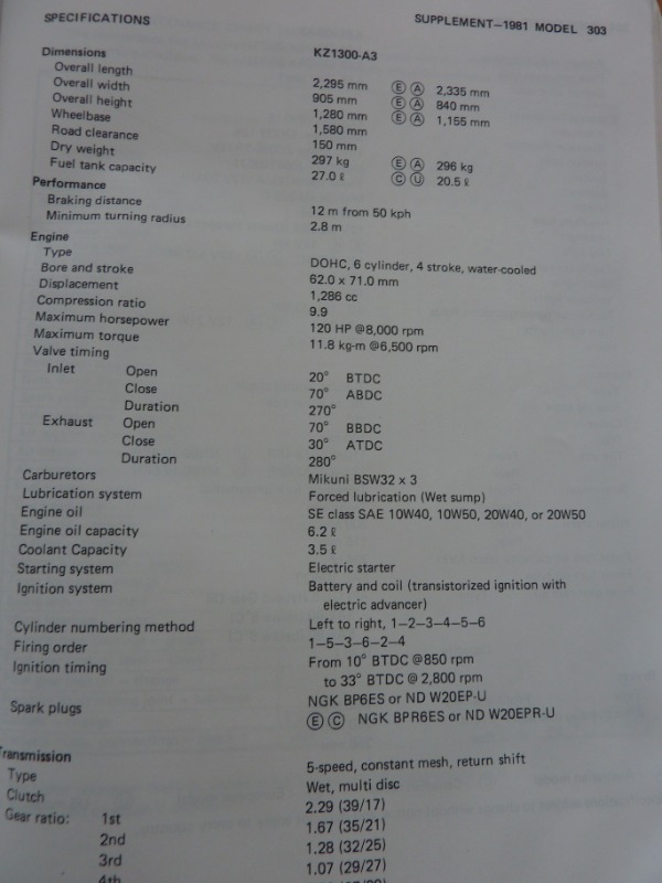

The 1981 supplement on page 303 now states the oil capacity at 6.2 litres . The 1982 supplement is the same 6.2 litres.
So the first question would be , how was the increased volume of oil - from 4.6 litres to 5.3 litres accomodated. ?

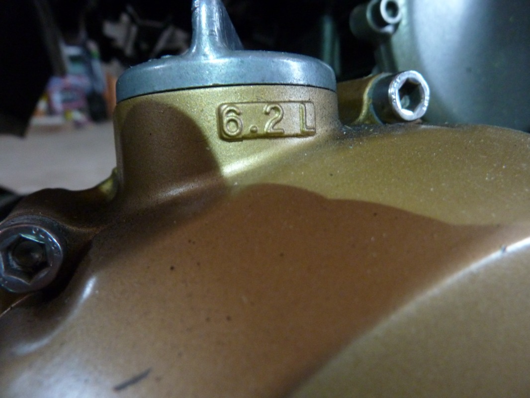

I installed the 6.2 litres oil pan along with the clutch cover with the larger window { good idea -- to easier see where the oil level is at }
I have never heard of or seen a third size oil pan - that is - there was only ever a 4.6 litres and a 6.2 litres oil pan. But made there is ???
The clutch cover with the bigger window is the same size as the original 1979 small window cover.

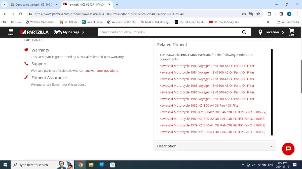

this is where I go to Partzilla.com and use (abuse) the privilege of their data base. This is a screen shot of the deep sump part number and which years after engine serial # used. As you can see as far back as 1979 after engine number 016038 the deep sump was used

That screen shot is misleading at best. Yes, the large oil pan will fit a 1979 bike , because the bolt pattern is the same, but it's not correct for that shot to suggest that the large pan 490345005 was original on 1979 or 1980 bikes , because it wasn't. the 79 & 80's part # 490345008.
Also, the service manual - printed jan 22 1979 , page 21 states the oil capacity is 4.6 litres. The photo above that table B 6 , is B 28 and it clearly shows the oil pan with the drain plug facing forward - that is the small pan # 490345008
. nt]
This company in the Netherlands has far better schematics, differentiating between kz 1300 and Z 1300--- ZG 1300 and ZN 1300
www.cmsnl.com/kawasaki-kz1300a4-1982-usa...0/pan-oil_490345005/
So anyone looking for the large oil pan -they even have one -- for 200 Euro.
