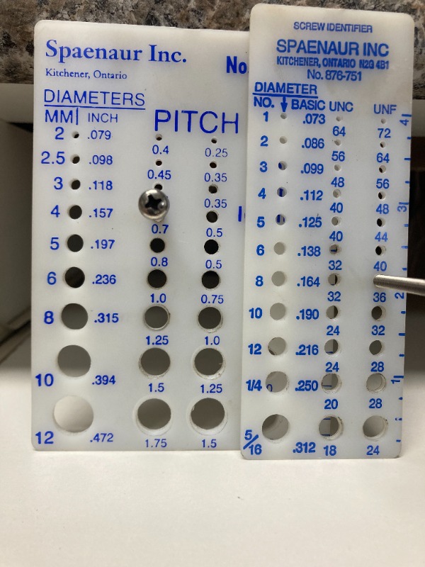

It is metric thread with Phillips head. M4 thread if i remember correctly, a longer screw can be cut to size. You should be able to find a distributor in US with metric size screws.

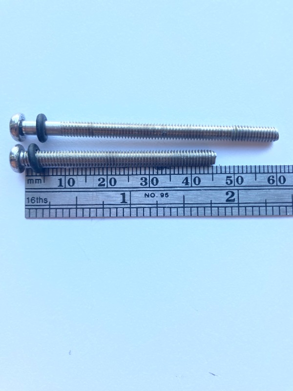

Thank you all!
Found a suitable replacement at local hardware store,
This 79 is so far from stock I don't mind if it's not 'oem'...
all is good!
