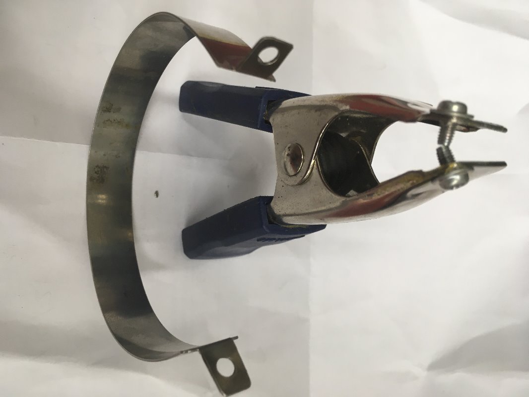

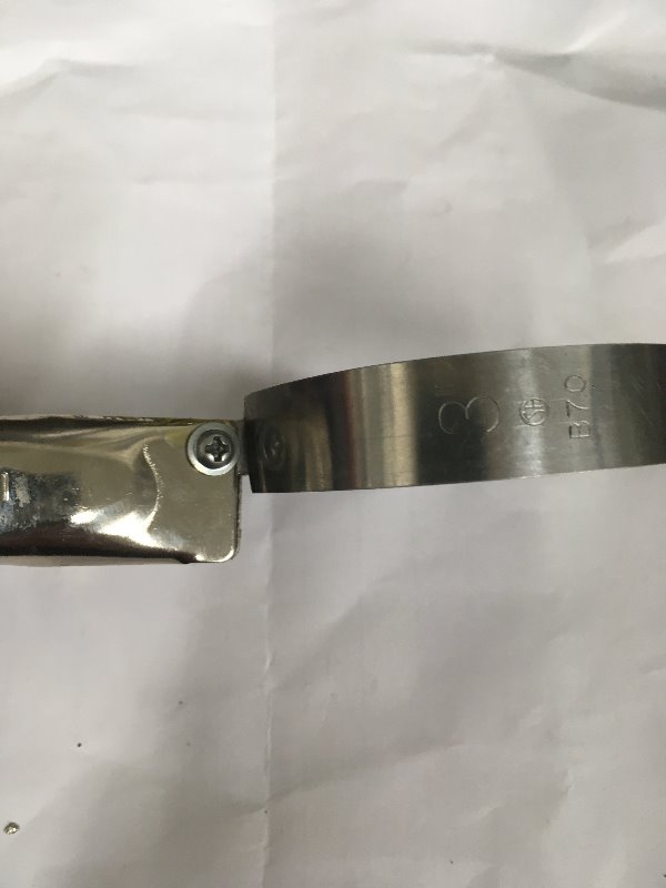

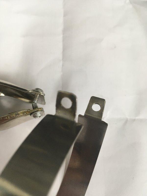

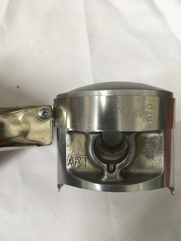

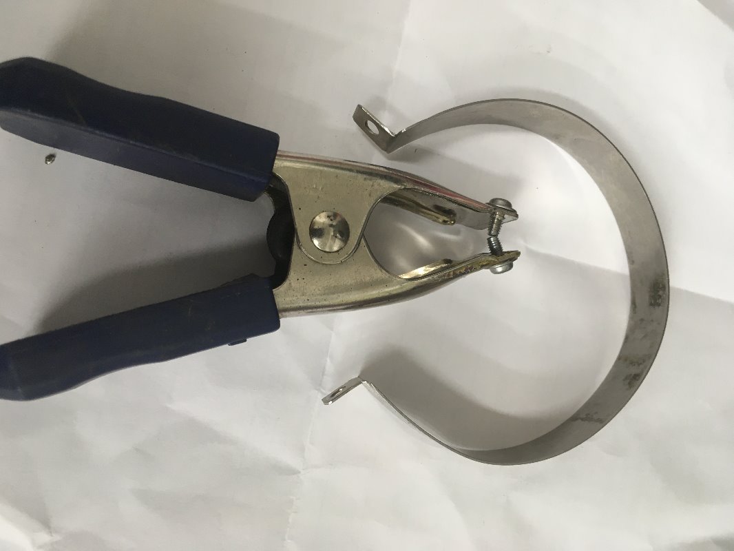

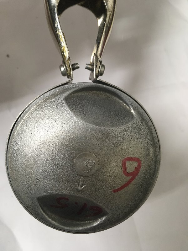

The pictures explain. The clamps have very strong springs. The bands are from hose clamps - heavier gauge. Tested them with the head (currently) on the bench and they work very well.

Interesting. The idea is to then have 6 of these when lowering the head onto the pistons?

If I have to make 4 more - no problem but I think I can do the assembly 2 cyl,'s at a time.

I considered "stuffing by hand" for about 10 seconds! Not too bad when the jugs are upside down on the bench. The "rounded" "Cruizinimage" rings wouldn't be an issue. These IMD rings have VERY sharp edges ! The compressors will let me keep my finger-nails and finger-tips.
