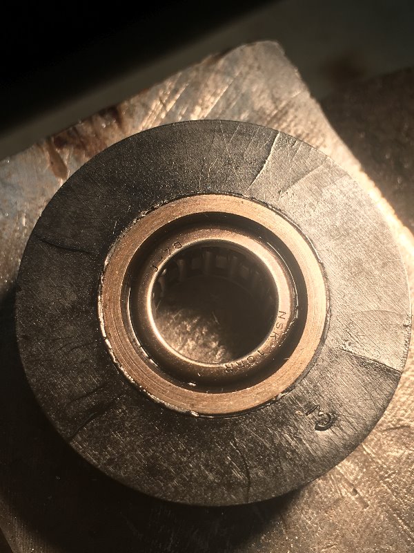

Has anyone found a replacement/alternative part for the C.C.T. rubber-roller? Mine looked great until I discovered radial cracks on both sides.

I remember "someone" bought one from the German shop, but I also saw rollers for the KZ on www/liska.com
Liska cam chain tensioner roller but it's not showing a needle bearing. Liska says it's compatable with the KZ1300, KZ650 and the KZ1000 but if I remember right the KZ650 and the KZ1000 have roller chains so the idler would have a raised lip down the center of the roller. Might be worth an email to Liska. $22.50
www.z1300.de has a listing for the tensioner wheel but at 92.50 Euros before shipping - Yikes !!

Thanks KB. On that site I found one that says Original Kawasaki and it appears OEM but how the Hell do you order anything from them ?
www.z1300.de Not a user-friendly site for the English speaking.
Elsewhere I also see another Kawasaki roller; and the use of a different style chain makes these inapplicable as you stated.

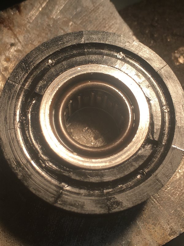

RE: Cam chain roller Thanks to kawboy for getting this rolling
"Gordon" has indicated that he can make a roller using "plastic". It sounds like this would be a "one of" for $60.00 us.
The bearings used in the sprocket and roller are "J-78", readily available - I purchased one for $7.00, locally and am currently "smashing eggs" !
I've mocked-up a two rollers - 1 nylon and one rubber. Still playing with these.
