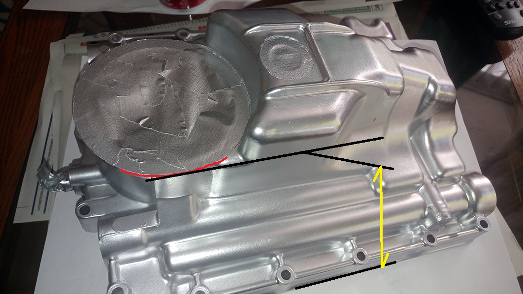

Looking for a measurement to determine if there's a difference in the relative distance of the pan flange to the oil-filter O-ring surface - Shallow pan vs. deep pan. Thanks.

Will do that in a couple hours scotch :)

I've been out all day so I got to it just now. It's tight there and no light in the garage, and I don't have the power to put it on the center stand as well. But I managed to come as close as I can to measuring it - about 80 mm.
