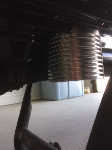

www.kz1300.com/index.php/forum/attachment/5834
The machinist stipulated a minimum of 12. They would sell for about $200.00us each. If there's interest I'll confirm the price.
Have about 3,000K on it and the results are gratifying. Lower oil-temp (10-20 C) and higher oil pressure (5-20 lbs depending on conditions) Oil temp. is noticeably slower to rise at slower speeds and cools down very quickly at speed. Have determined it holds almost 1 litre extra and oil changes (just did my third with the adapter) are a real treat. Virtually no mess! The WIX filter cost me $8.00.
If 12 or more of you are interested then they would be available.
If you're wondering about the minimum it's because the shop cuts the adapter on a $1,000,000.00 (Yes - 1 million) CNC machine and he just had a new, larger one installed this summer. The Japanese techs were in his shop for one month, cutting the floor and placing 5 trucks of concrete for the required engineered floor and setting up the machine. My point is: This is a full-on CNC shop with state of the art machines and the lathes rarely stop. So...........12 minimum for the trouble of fitting these into his regular production, to cut these bits.
