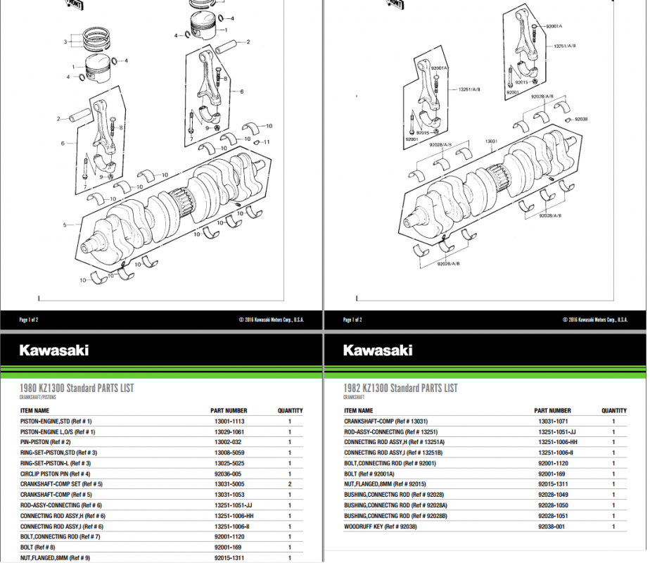

No idea about what the II, JJ, HH's are sorry but these guys might know.
Bike Master 900
Here are the Parts Diagrams for both the A2 and the A4 side by side and by looking at them together it looks like they might be the same. It would still be nice to know what the difference was between 13251-1051-JJ, 13251-1006-HH and 13251-1006-II though.
The Excel spreadsheet parts list (available from this website) references a 'spec code' with :-
JJ being the 'G' mark
HH being the 'H' mark
II being the 'I' mark
Bike Master 900

Just found this on ebay and the guy talks about one superseding the other
Ebay Conrod Item
Part number: 13251 1051-JJ superceeded from 13251 1006-GG (13251 1051-GG superceeds to 13251 1051-HH then 13251 1051-JJ so all same part)
Ebay Conrod Item
