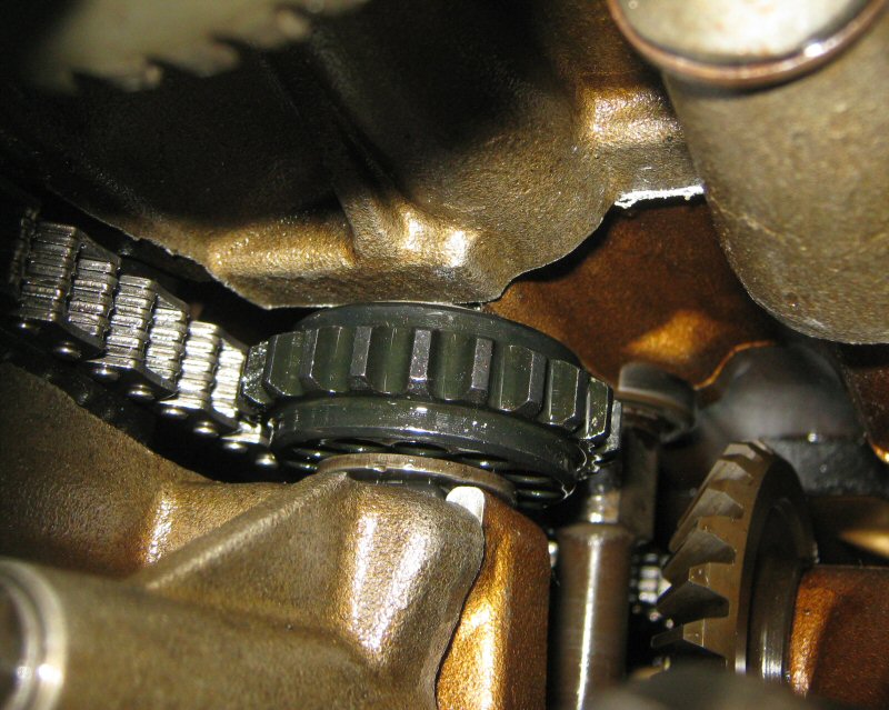

Hi all, well i'm on my 4 weeks annual vacation here in sunny Queensland Australia, so a good time to pull the head off and change over the cam chain cog to the new metal one I got a while ago, also did the valve stem seals while the head was off. It went reasonably well, only dropped one little thing down inside the motor, one of the little rubber blocks on the idler cog shaft end, hate doing the valve stem seals as I always have trouble with the collets, anyone got a good tip on how to do them easily or a photo of what valve spring compressor you use ??, I made up a bit of a crap one, does the job but not easily, anyway the old cog has been in the bike for a couple of years now, probably for 15 to 20 thousand kilometres, and with the replacement tensioner from the 1100 (or what ever it is)with the spring cut down, i'll add photos, still have to check the shims, put it all back together and run it and re-tension the head bolts, also if anyone wants to see the timing on the cam chain i'll add a photo of that. Ok fingers crossed all continues to go ok, can't handle too many stuff up's. getting too old and shaky for this again, cheers Pete.

Good work, Pete. Thanks for the detailed photos. I'll be doing the same job once the sun returns to the northern hemisphere.

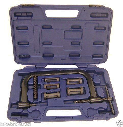

Ok I bit the bullet and spent some of my holiday pay, bought a "proper" valve spring compressor tool that "should" fit my valves, car ones just don't have enough room to get into the angle of the valves, well they do but it's a real bitc*

kza13 wrote: Ok I bit the bullet and spent some of my holiday pay, bought a "proper" valve spring compressor tool that "should" fit my valves, car ones just don't have enough room to get into the angle of the valves, well they do but it's a real bitc*
Funny thing I just ordered a similar set before xmas Pete
