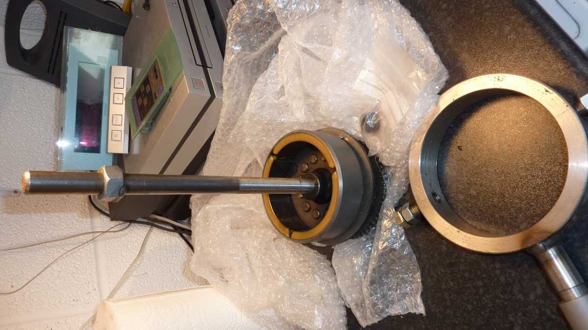

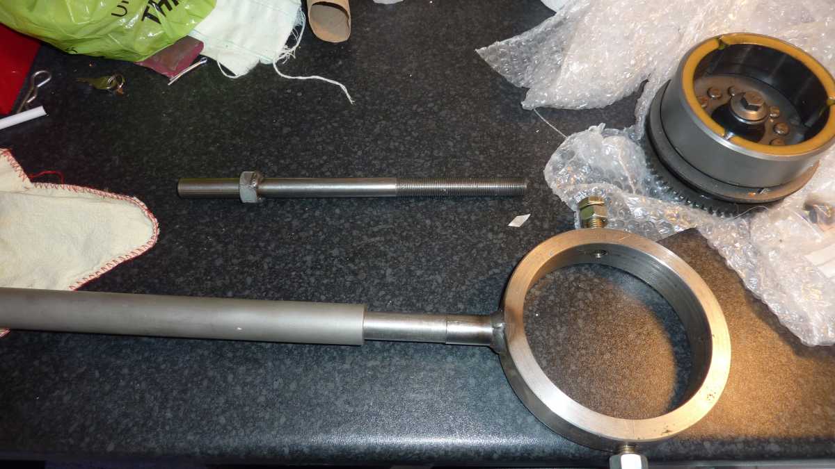

Bill, I am seriously devoid of any engineering skills, so my mate kindly took pitty on me and fabricated a couple of tools to replicate the Rotor Holder & Puller shown in the Kwak Service Manual (I think he just tried to copy those shown on page 345)
I am sure you can quickly knock something up, but here are some pics of the items: the Rotor Puller was just a length of bar with a nut welded in situ: pretty sure it was 16mm right hand thread, but cant recall what the the thread pitch was :oops:
I know they work as (sadly) they have been used more than once :whistle: :whistle:
Cheers Tim
