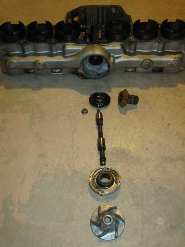

found out my waterpump empeller not rotating when engine running...
going to tear into it next week....What are chances of finding pieces to fix?

The plastic bevel gear is probably the culprit, but you could pull the end cover for the timing shaft behind the cylinders and make sure it's not the chain. Either way the cylinder head has to come off.
This pic may be useful...
www.kz1300.com/media/kunena/attachments/447/IMG_4872.JPG
