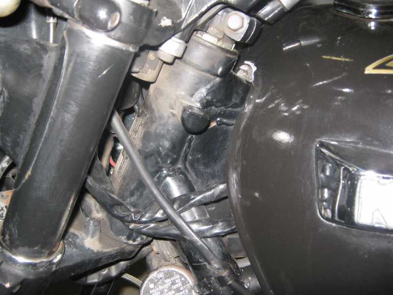

- Posts: 594
Re: Main Wiring Loom
12 years 4 weeks agoIgnore the black painted red wire, I have a broken power wire in the harness and just ran a power wire to the headlight bucket to bypass it
12 years 3 weeks ago
Awesome thank you.
