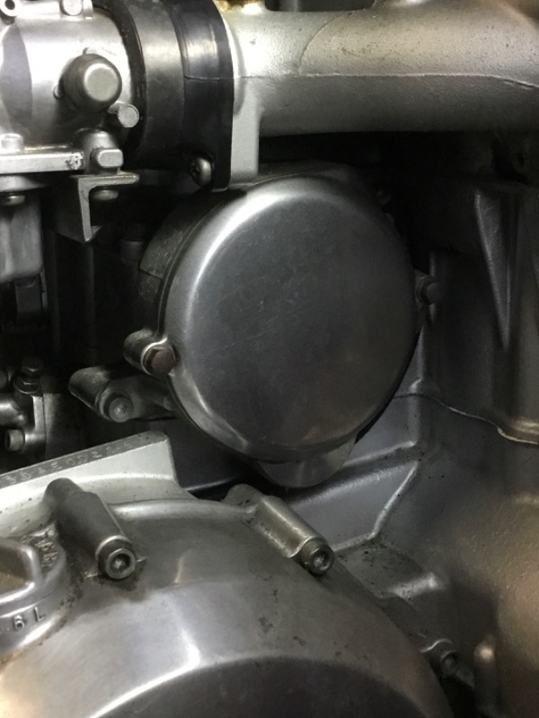

On the'79, the pulser coils are under the small( 4") cover just under the carbs.

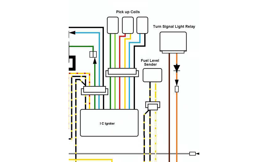

I always like to refer to the wiring diagram for reference when trouble shooting electrical.
I think you should really start at the 6 pin connector up near the igniter. Kawasaki refers to them as pick up coils.

5 years 2 months ago - 5 years 2 months agoNo, On the 79 A1 the ignition pick-up coils are under here, aren’t they?
