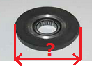

Can anyone help me with this measurement.
The camchain tensioner guide at the rear of the engine in the centre has a Nylon Gear at the top & a RUBBER Wheel at the bottom.
The K Manual does not appear to give a service limit for the diameter of the Rubber Wheel & thats what I need (image below).
If anyone has a new (or nearly new) one, could they possibly measure it & let me know, preferably in MM.

I have a brand new one waiting to be fitted. The exact measurement is 36.08mm.

Thanks mate, exactly what I needed !
