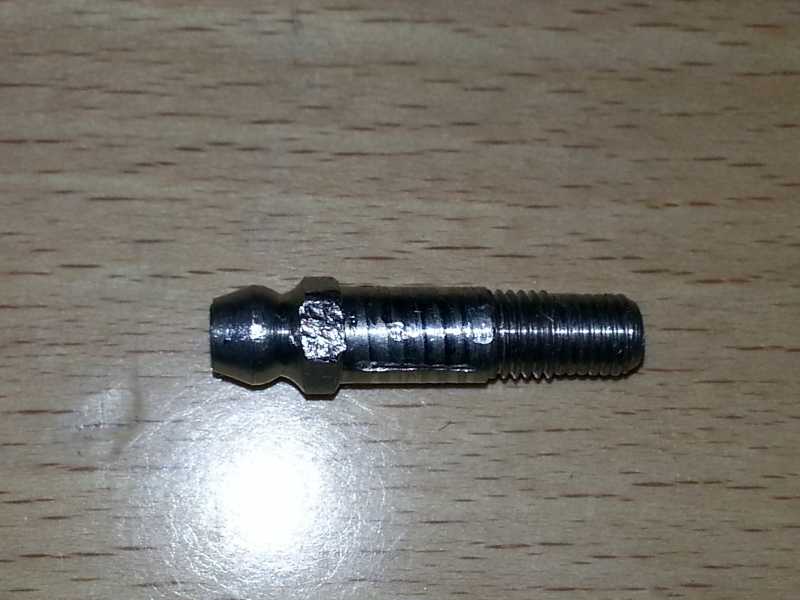

Hey guys,
Just finished making a home made float level gauge. I found a long reach grease nipple that I happened to have in my tool box (knew it would come in handy one day ). Cut the appropriate thread on the end, drilled the ball and spring out.......and here it is.
All I have to do now is get some clear plastic tube an hey presto.......all done.
Best thing of all, it has cost me nothing. Even better. Thanks guys for pointing me in the right direction. That's what I love about sites like this
