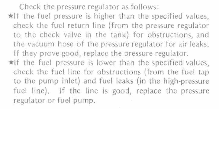

Reading through the Digital Fuel Injection System in the ZN1300 Service Manual, on page 3-24 it suggests that the fitting in the tank is a check valve.
