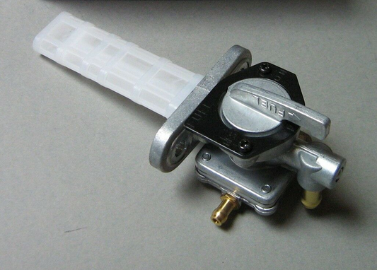

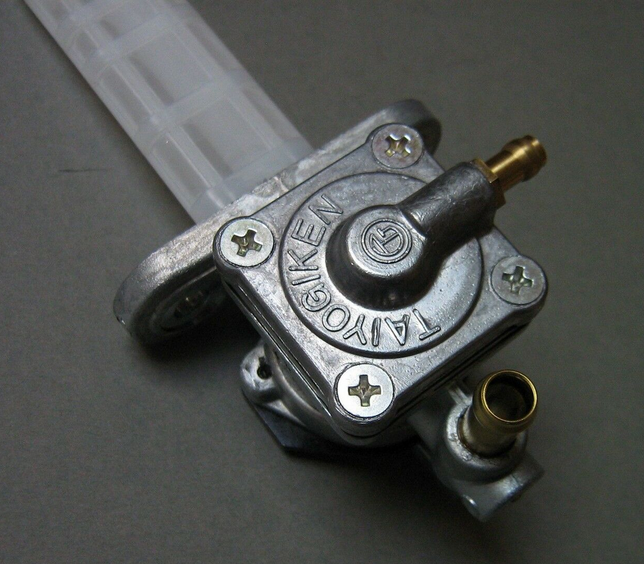

Any chance you can post some pictures of that fuel tap? Curious if it's an option for a ZN1300. I don't need one presently but wondering for future reference.

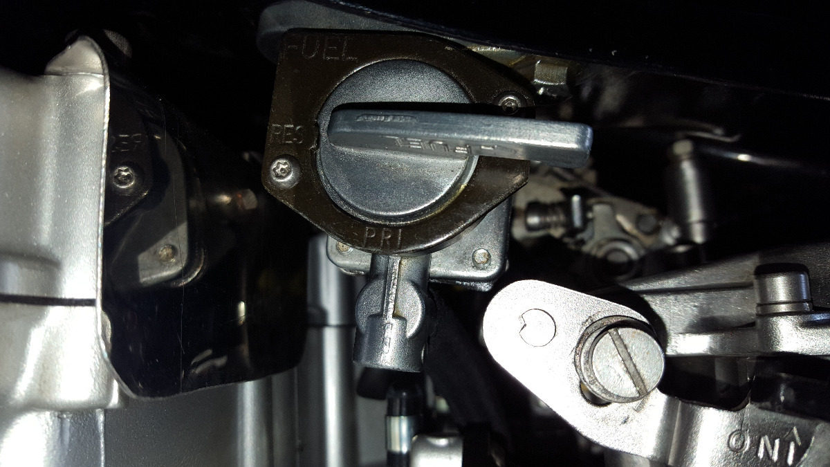

Here you go !
GPZ900R Petrol Tap.
Has the same hole Centre to Centre as the Z/KZ1300.
You can remove the rear vacuum plate and re-fit with the vacuum pipe in a different direction.
One of the photos is the same tap fitted to my current Z1300.
