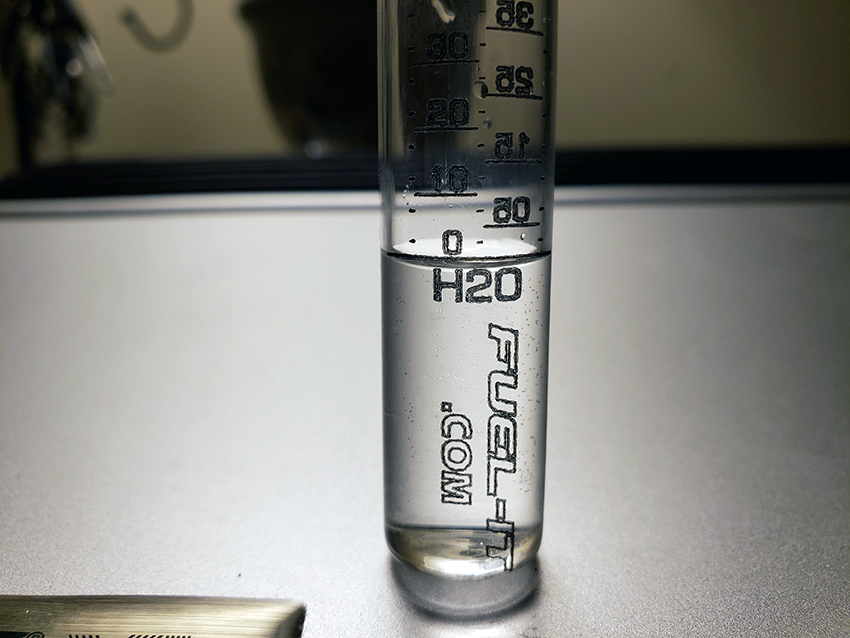

First batch here - Chevron marked ethanol free gasoline. First photo water up to the required for testing level - just to show the process.

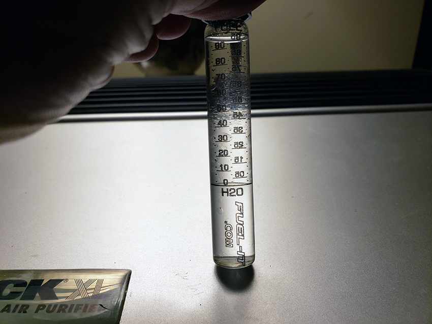

Now, filled up with gasoline, shaken and left to settle. Verdict - Chevron marked as 'Ethanol free' delivers 100%. Absolutely no H2O to kill your carbs!

Hey Holger.
I use an ethanol in fuel tester bought from Ebay. This one:
>>>>>>> Laser Engraved Fuel Tester for Ethanol and Gasoline
You fill it up to the marked level with water, then top it up to the required level with fuel. Mix it, let it sit. Water and ethanol will attract each other bonding, showing how much ethanol in the tested fuel you have by displacing the water/ethanol-fuel line. If it shows 10, that 10% ethanol. This one tested stayed at 0, meaning there is 0% ethanol in that particular sample from Chevron sold as 95 Octane 'No Ethanol' at the pump here.
Stan
