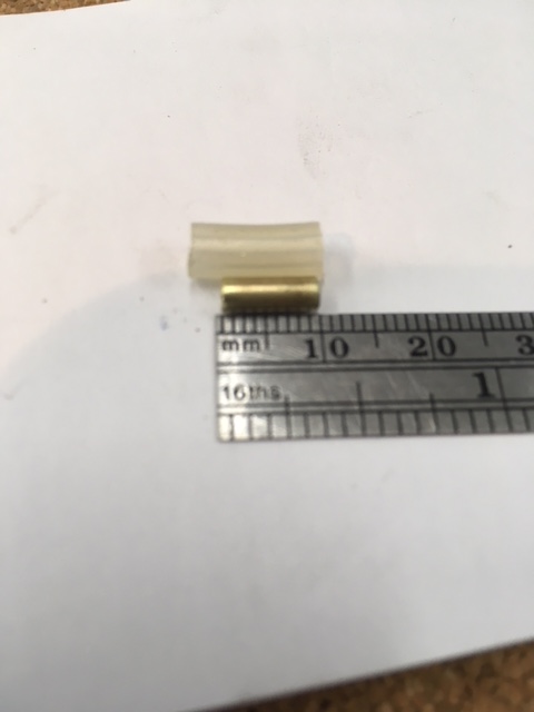

3rd test. Bike has sat for 6 full days. Turned on fuel, listened to bowls fill, touched the starter and it fired up immediately, again. Reduced the choke for a 1200 RPM warm-up idle.
This appears to be the solution to the notorious hard start problem and the modification is remaining as installed.
Amendment: I screwed-up when I cut the brass and silicone for the picture.:pinch: Sorry 'bout that. :oops: Reverse the lengths !!!!! The exact lengths are not critical but the brass tube must be longer then the silicone tubing.!!!! Neither can extend into the choke-piston well (for obvious reasons) !
Reverse the lengths !!!:silly:

Stan from the points Scotch made about the design of the carb specifically, I think this mod is applicable to any age and condition of carb or engine, as the issue addressed is not caused by wear, but fundamental design?
The only thing that might 'disguise' it's effect is if you happen to have a super-fast starter motor which will re-prime the choke circuits faster than a slightly tired one (just mean a faster engine spin = more vac = more fuel draw), but again the theory means even then you should see a measurable improvement with the mod?
