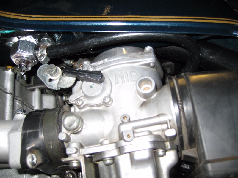

Had the same problem. I removed the solenoid, fitted a pingel fuel valve, turned the fuel inlet on the carbs upwards and reconnected the fuel line. I've had no more problems since.
