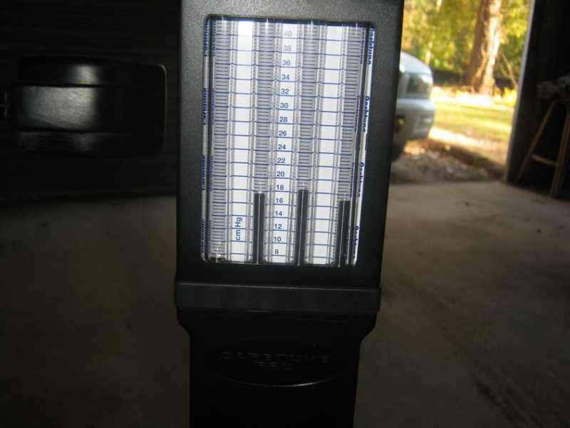

I've looked everywhere, there are tips on how to balance the carbies, but no info on what they should be set at, here's the gauges when idling after the adjustment, well I did get them a bit closer after the photo

I believe the goal of the carb sync adjustment is to get equal numbers whatever they may be.

I still can't understand why there isn't a "minimum" setting for the vacuum gauges, the ideal sweet spot, I think about it and it makes me wonder, logic tells me that if you set it "high" then the vacuum will raise the slides, so that's why I asked about it. There just has to be a setting somewhere that you would try and get the flow right, or else the higher the vacuum the higher the slides would be, it's just how they work. If there isn't a setting to try for then what would stop you putting it anywhere you want to ???, still confused

Hi Pete,
Getting the flow right isn't important. Getting the three carbs to flow the same amount of air is. I believe the vacuum is supposed to be within 2 pounds of each other.
When adjusting the sync on these carbs we don't really care about the absolute vacuum. It changes every time you open or close the throttle. All we care about is that as the vacuum changes each carb experiences the same amount of vacuum.
