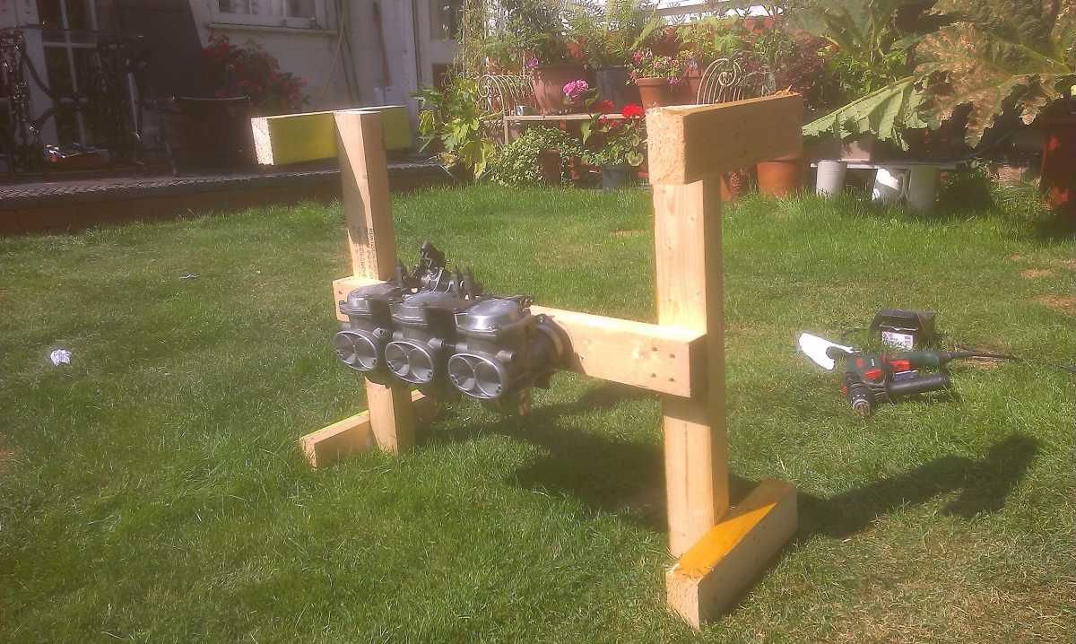

Thats definately on the list when the budget allows, in the meantime, I'm sick of carbs wobbling around on the bench and had some spare rubbers and bits of wood so spent half an hour knocking this elegant device up.
