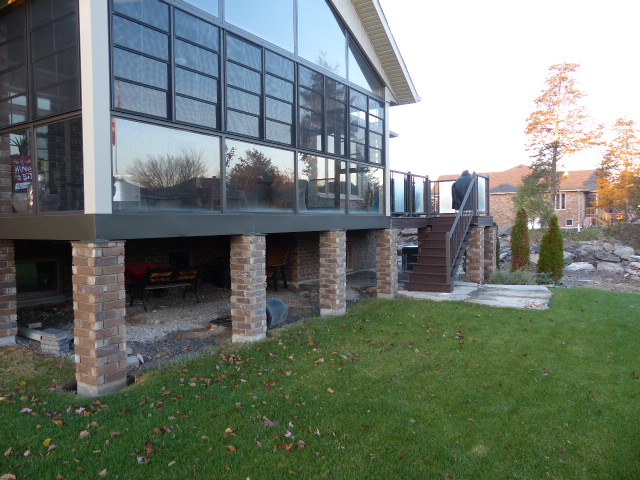

We wanted a wing deck for the BBQ but the builder wanted stupid money for it and I said I would do it. So here it is.
then we needed a driveway. We could have had it paved with asphalt, but for the same money I could buy concrete pavers and just do the grunt work and put in the driveway. So here it is.

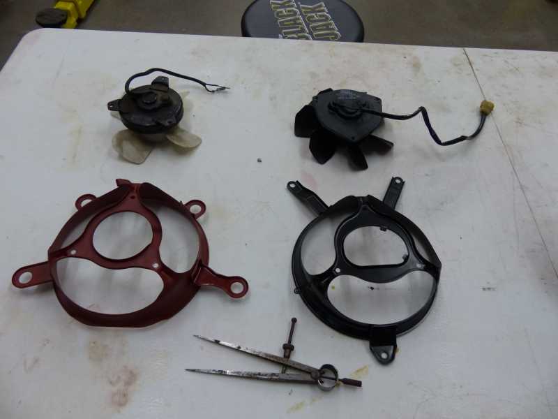

So, I have time now to spend back on the project. For what ever reason I decided to pull out the rad fan and look at it. There a few posts in the FAAQ section about overheating issues and although I personally believe there's no engineering problem associated with the original design, I've elected to update the rad fan just because I can.

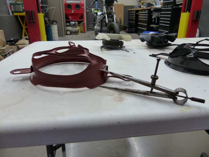

I've picked up a ZRX1200 rad fan from EBay for $40.00. It's a 7 blade design with similar lift in the blades and at first it looked like I could just remove the motor and fan blade and bolt it right in to the old shroud, but of course the bolt pattern was off just enough that I would have to really bastardize the mounting holes to get things bolted up, so I've elected to cut the top half off of the ZRX1200 fan shroud and the bottom half off of the old shroud and weld the 2 shroud halves together. In order to get the right height for each of the pieces I've marked the 2 shrouds with a set of dividers referencing by placing the shrouds on a table and measuring up from the table. That way after it's all welded up the fan blade will be located in the same place as the old fan blade was.

So, does the new house have as much shop space for playing in? As usual, the house work is as nice as the bike work! Once again, Kawboy, we are so much alike! I can't stand to pay someone else to do what I can do, and even better, just for the sake of expediency! Very nice looking driveway! I love the choice of pavers! Nice deck, too! Do the posts get painted too?

Trikebldr- Do the posts get painted - No since posting the pics I bricked them all up (all 6 posts) with 650 bricks I found laying around the lot then capped them off in aluminum.

Very nice brickwork, BTW!
