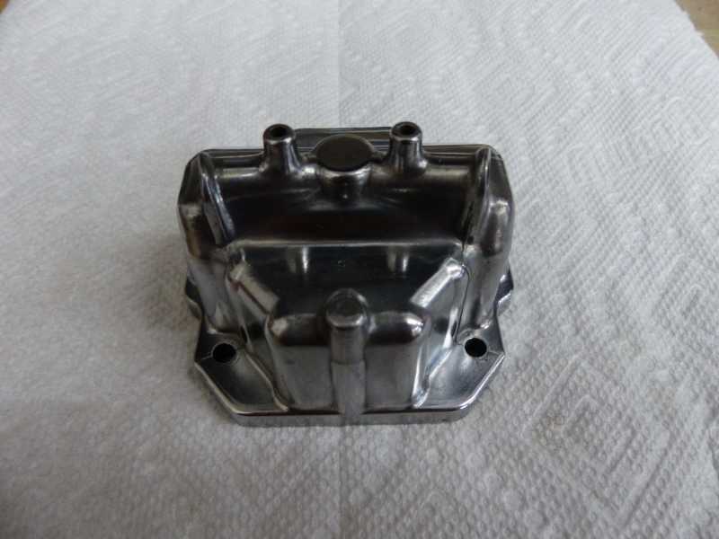

Today I went back to working on the carbs. I have the 5-6 float bowl off and initially air tested it and found the choke circuit supply tube in the float bowl was blocked. I've used throttle body cleaner before for cleaning varnish off of carbs and intake systems and I like using it because it's in an aerosol can with a spray tube and works great for small cleaning and checking ports are clear. To each their own I guess.
the carb bowl when it came off was spotless inside and after I squirted the cleaner down the choke feed tube within seconds it blew clear and while I was flipping it around I saw what looked like a jet in the bottom of the choke feed tube. sure enough there's a stepped orifice down there. First step is .062" and the second step I can't tell but it looks like it's about .025" - .030". Doesn't matter since I got it cleared out, but I was really surprised to find it in the bore.
Also, I used the throttle body cleaner to clean the "spotless" carb bowl and couldn't believe the residue in the inside
Just for giggles I got my Autosol polishing compound out and thought I'd give it a whirl on the outside of the carb bowl. 20 minutes and here's the result.
Don't know if any of you are familiar with this product. I like it for finishing off after I've used red rouge polishing compound. In this case I just went straight for the Autosol.
Anyway, that's it for today folks.
