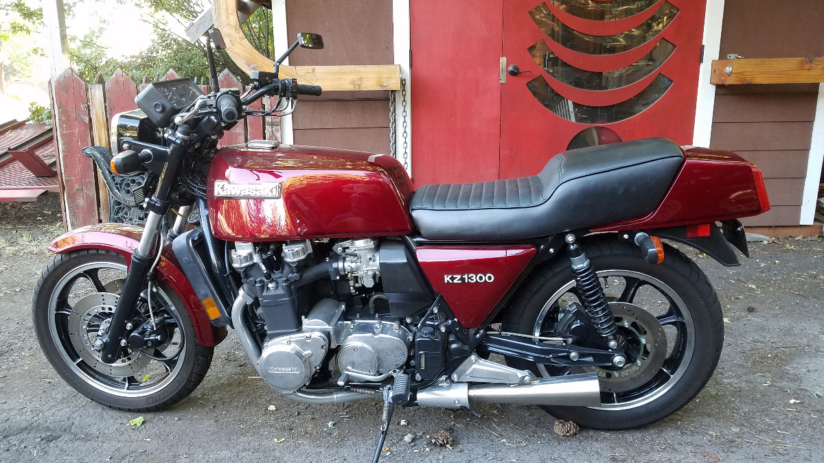

It seems to me that the most common problem with 1300s is over rich mixtures and flooded #1 carbs. A friend of mine has been struggling with just these issues on his recently restored 79 1300. It's a beautiful bike, don't you agree?
This was a bare frame restoration. Check out the stainless steel six into two exhaust system. I've got my suspicions about where the problems lie but I'm going to start by making sure the engine is properly set up. To me that means valve clearance check is first. Then a close inspection of the carb innards and if they're not already in there a Dyno Jet kit and needles. The owner reports the bike runs great for 30 to 50 miles and then fouls the #1 plug. To me that says too high fuel levels.

Yes, it looks good to me, Bill. A neat exhaust - does it sound good without being too loud?
The black engine treatment seems to be popular now.
If the bike was mine, I’d definitely add some stripes to the tank, side panels etc..
Good luck with the carb work.

I've literally hit the wall on bikes. I don't have any more room, especially since I built that trike.
I'm doing this job as a trade although I'd do it for nothing more than the learning experience and the opportunity to document the process. As I said in my first post I believe this carb issue is the most common problem that new 1300 owners have to face when rehabbing a 1300. I'll be calling on you folks for advice as I get into it.
