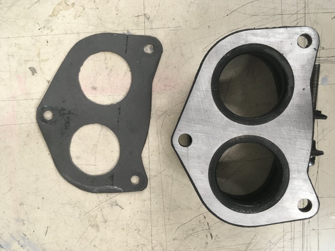

First thing that comes to mind is a vacuum leak. Whether carb'd or F/I , a gasket between the holders and the manifold will eliminates the vacuum leaks there.
Sand the holder surface as shown and add the gasket (dry)

Scotch is on the right track. Lean fuel mixtures cause backfiring. After 27 years of sitting, gaskets and rubber components dry out and leaks can occur. Also, check the rubber flanges that hold the throttle bodies for leaks between the flange and throttle bodies.
1.
if no leaks are found, 2 things come to mind.
Fuel injectors have been stuck from 27 years of sitting in stale fuel and likely need cleaning.
2. Throttle position sensor is not giving a solid signal back to the DFI Computer. It's a simple rheostat and may need a bit of contact cleaner to smarten it up.
1.
