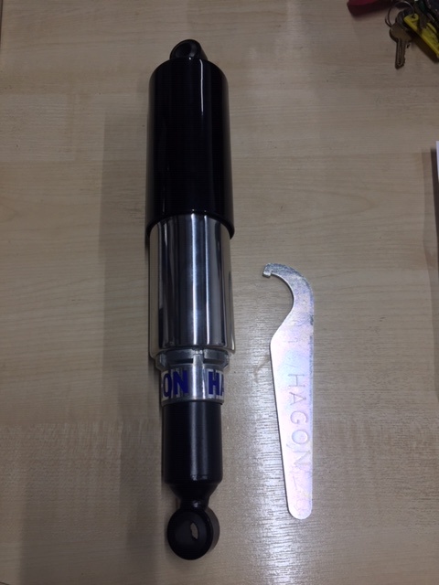

In the meantime, some goodies arrived!

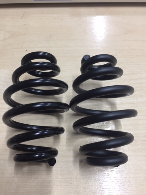

Interestingly the springs have a different finish: one is gloss, the other matt. I have requested another, no matter which, as long as it matches one of the ones I already have.

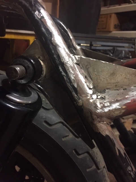

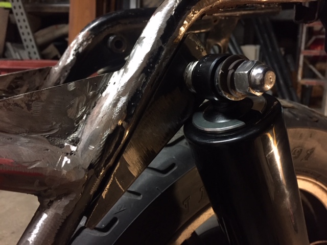

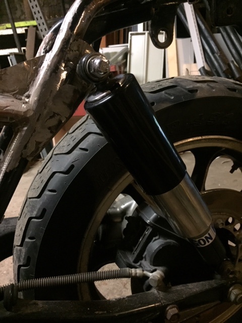

Grr... this is what you get when you are fabricating without all the parts available.... shock top touches the mount.
The hole for the shock mount is a few millimetres too deep into the metal triangle.
Only way to rectify that is make new ones...

The shocks look similar to stock. Except the springs. I think they will look good on the bike. But why they would send one gloss and one matte puzzles me, but not unheard of suppliers mixing things up.

Instead of making new shock mounts, I dropped a weld inside the corner of the mounts and shaved the outside off sufficiently to clear the shock. Then welded both mounts in. I still need to tidy it all up and plug a few holes in the welds, but I will do that when I have the engine out and am prepping the frame for paint. For now I just need it to be fixed.

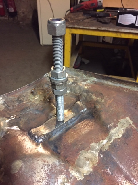

I have also asked the resident welder to weld a plate and a pin onto the bottom of the tank. That will enable me to clamp the tank in place against the frame. The front pins and rubber mounts I did last week.
I also ground off part of the ridge on the rear RH swingarm so I can get a fatter rear tyre in. I left a little bit for strength, but about 4mm came off. The biggest difference however was taking the strengthening panel that hoops around the swingarm back by about 1cm.
