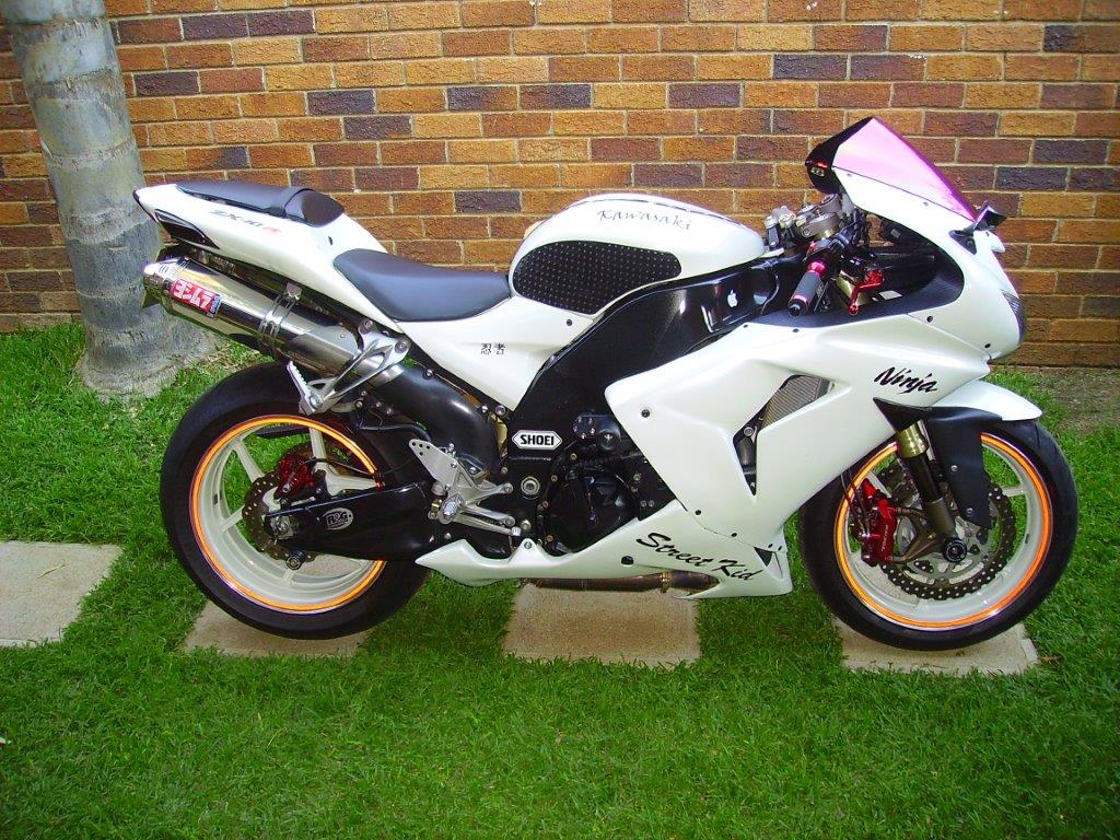

lol Ledkz.......I have a similar situation. Have a worked ZX10R which now sits! Just love the old 1300, use her daily. Even had to charge my car battery the other day for lack of use
