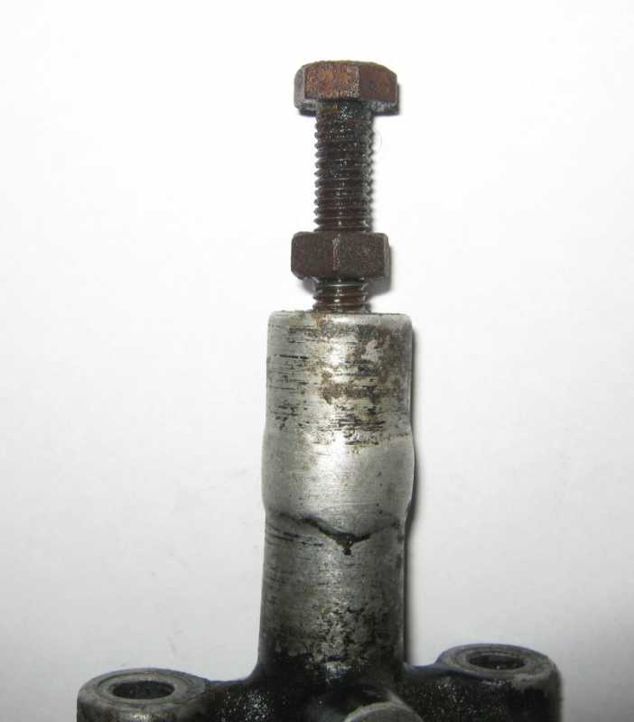

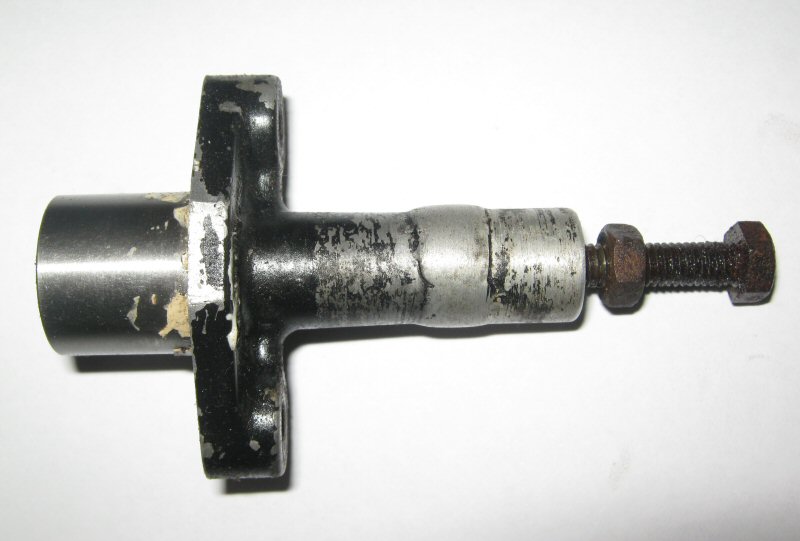

#13827
Knew I had an old one around the place, previous owner, a mate of mine adapted his old tensioner to a manual one, as you can see by the photos he welded an extra piece of aluminium onto the end and tapped that out for a high tensile bolt and lock nut, just thought i'd post the photos to give you an idea on how to make the bolt in the end idea better, cheers Pete.
