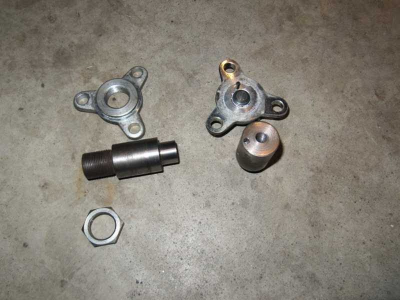

I had to drill and tap larger than 8mm to get them out, I think I went to 10 or 12mm fine thread. I used a large impact socket and a heavy grade washer under the bolt to make a puller. I tightened the bolt and the hit the head with a hammer to break the pin loose then used the bolt to finish extracting it. I had ZERO luck with a slide hammer.
Interesting to note, the very early 1300's had a threaded swing arm pin. I had to replace my swing arm and the used one I bought came with this style of pin and holder. I think they are FAR superior to the press in type with the set screws. I would try and find a set like this when you put it back together, they are much easier to adjust the swing arm preload and position. AND they will come back apart much easier.

10 years 3 months agoTyler wrote: I had to drill and tap larger than 8mm to get them out, I think I went to 10 or 12mm fine thread. I used a large impact socket and a heavy grade washer under the bolt to make a puller. I tightened the bolt and the hit the head with a hammer to break the pin loose then used the bolt to finish extracting it. I had ZERO luck with a slide hammer.
I've gotta say it surprised me when I discovered the 13 had this set-up for the swingarm pivot - every other shaft drive bike I've ever worked on has had screw in pins like the ones you have pictured above.
Thanks for the tip on cutting a bigger thread - I'll have a go with the slide hammer and heat on the M8 but it's good to know I can up the size if that plan turns to poo.
