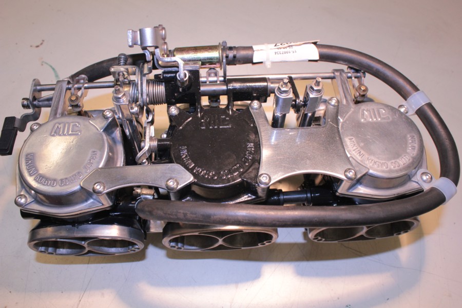

After rebuilding I configured two sets of cabs like this, for a 1300 owner
 WIX # 33027  used these for years.  Don't let it's size fool you.
