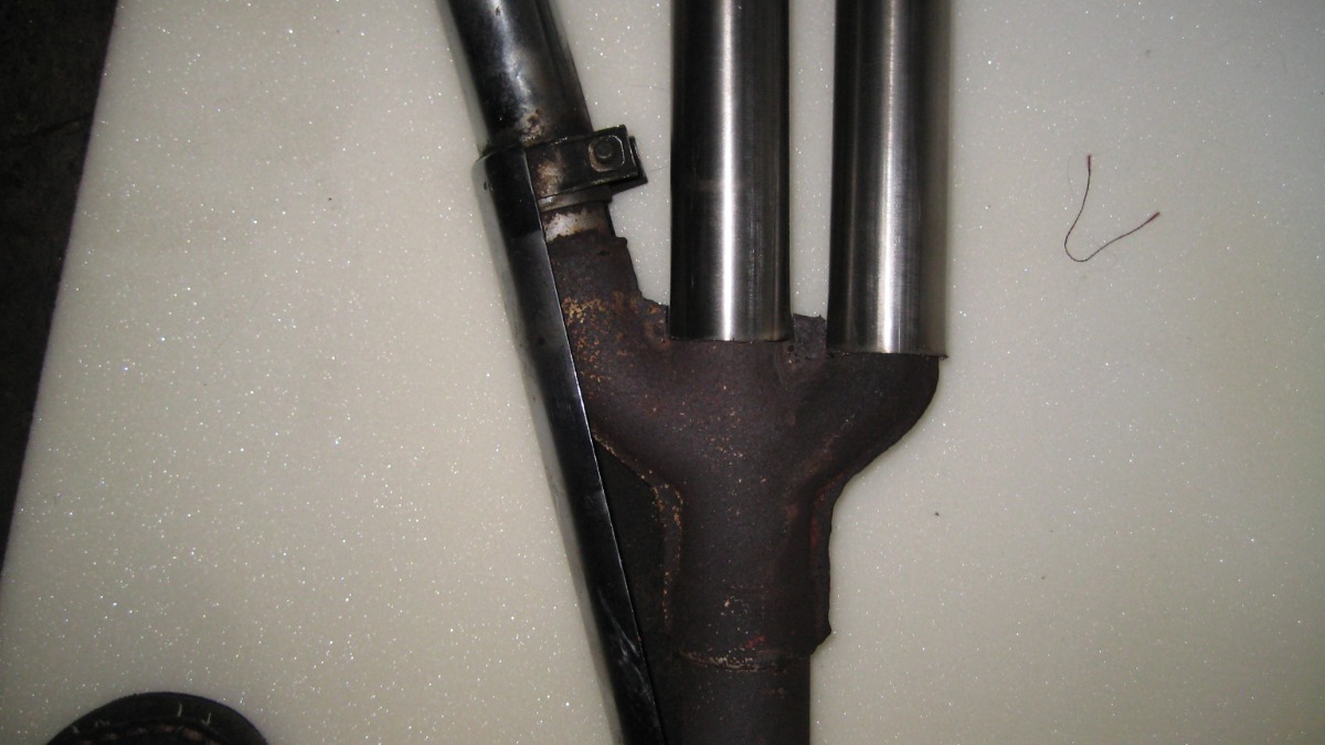

The exhaust on my 13 has almost rotted away where the downpipes meet the 3 into 1 manifold. The rest of it seems to be in quite good condition so I am going to try to repair it. I bought two lengths of stainless steel pipe, one 35mm and one 38.1mm. One is a tight fit inside the other. I cut the rotted flanges off the manifold, and hammered  the thinner pipe onto the cut ends. I will need to trim a bit off the downpipe and fit the larger pipe over that. I still need to measure the exact lengths for my cuts so the two  fit snugly together. That’s the theory anyway, so fingers crossed it works. Here’s a photo of progress so far.

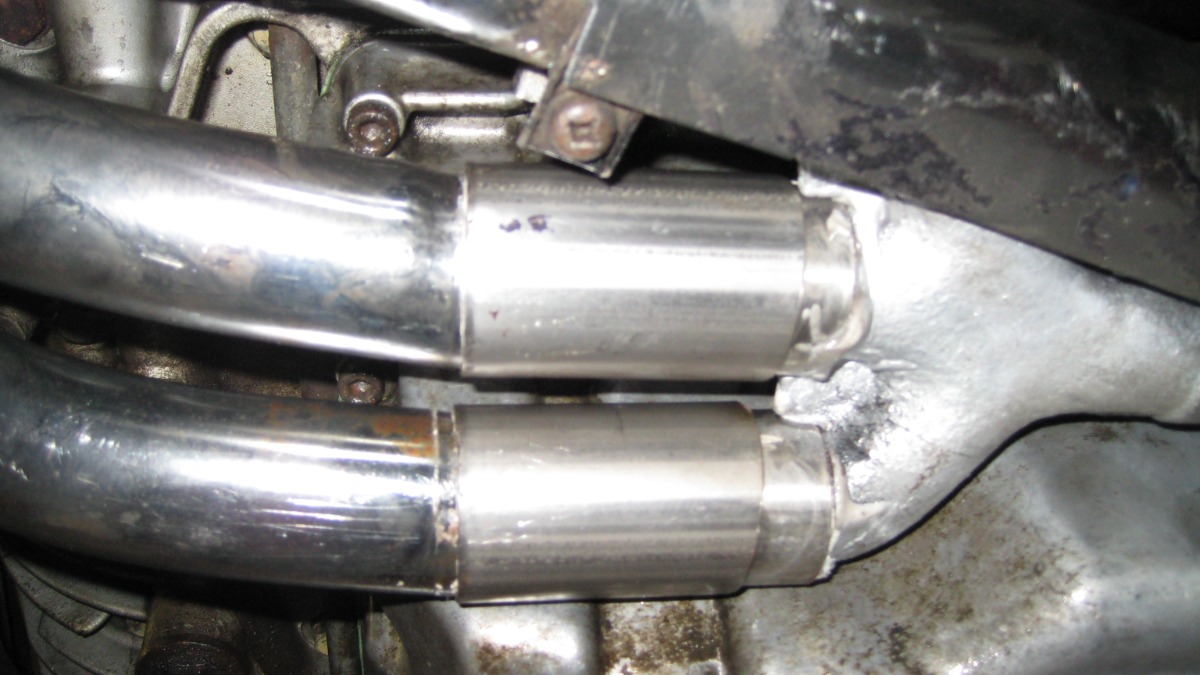

Finished my exhaust repair today, so hopefully I've saved myself the price of a new one.

Well done.   What holds the pipes into the collectors?

#29818
