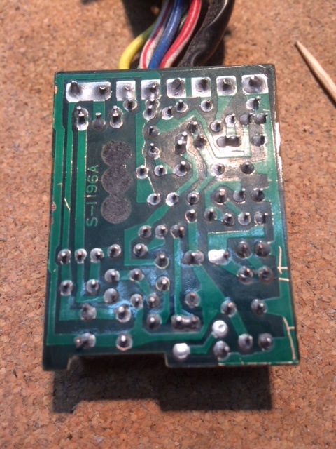

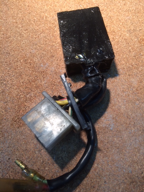

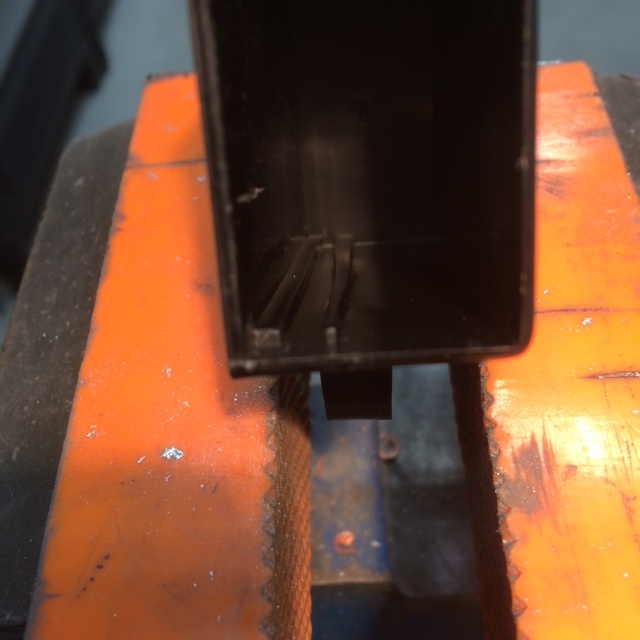

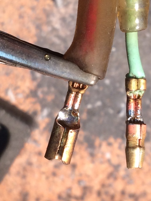

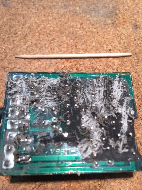

Thought I'd remove the cancel module and see if I could determine why it hasn't worked for almost as long as I've owned the bike.
I warmed the case and the end-cap released and the potted-circuit-board pulled out cleanly ! Soaked the entire block (epoxy) over night in some lacquer thinner. Next day I started picking. Once the soldered side of the board was cleaned I fluxed the terminals and re-soldered each one. Also soldered the 6 harness block and 2 bullet plug terminal ends. Plugged the unit back into the bike and using my cordless drill (chuck) I spun the front wheel. 24 rotations and the unit turned the signal off. Repeated several times. Unit now works. The circuit-board slides into to the case in a track. Used some hot-glue to secure the board in this track and a bead on the inside perimeter to seal the snap-in case-end.

I was a little disappointed in not seeing an obvious bad solder connection. Unlike my last OEM style V/R.
Bad V/R joints !

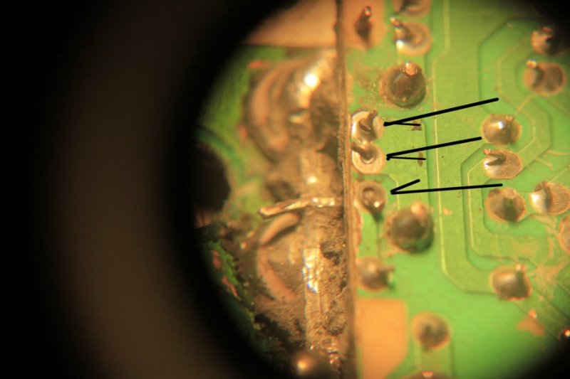

A close look at the "Cancel" board (with some magnification) showed a few soldered terminals that were "dull" but nothing that was an "ah-ha" moment. I was prepared to dig-out the component side and test each until I found the defective one. Fortunately, re-soldering each connection fixed the issue.

In the last photo the top connection looks loose, and I'm making out the other two were not solid as well. I think these were actually your smoking gun.
