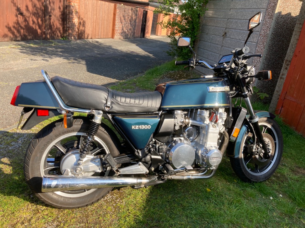

Thanks Scotch, I’ve just finished stripping and cleaning with your carb tool and rebuilding the carbs yet again. I was quite surprised how many little bits of debris came out and just how discoloured the thinners was even though this is the third time I’ve cleaned them. I must admit this time I did them exactly as your instructions where as before I might have cut a few corners lol. I’m not refitting the carbs till tomorrow so while they’re on the bench I’ll have a look at the pilot screws through my jewellers eyeglass.
Also while they where on the bench I’ve removed the enrichment diaphragms and put the cover back on with a gasket.
thanks once again for your input and patience. I’ll report back tomorrow when I fire her up again. Fingers crossed that I’ve sorted it.

Well finally she’s running properly, bolted the carbs back on and after a bit of balancing she runs as sweet as a nut. The tickover is a bit fast and the adjuster is fully backed off so I think I need to redo the balancing.
Thanks to everyone for their input, hopefully i can just enjoy riding the beast now.
