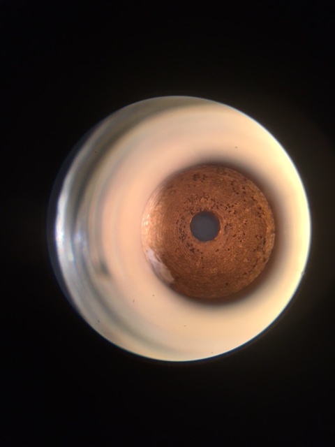

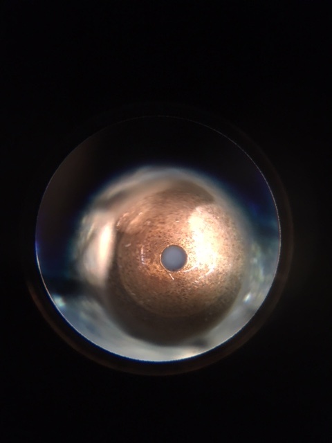

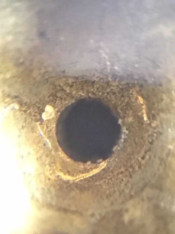

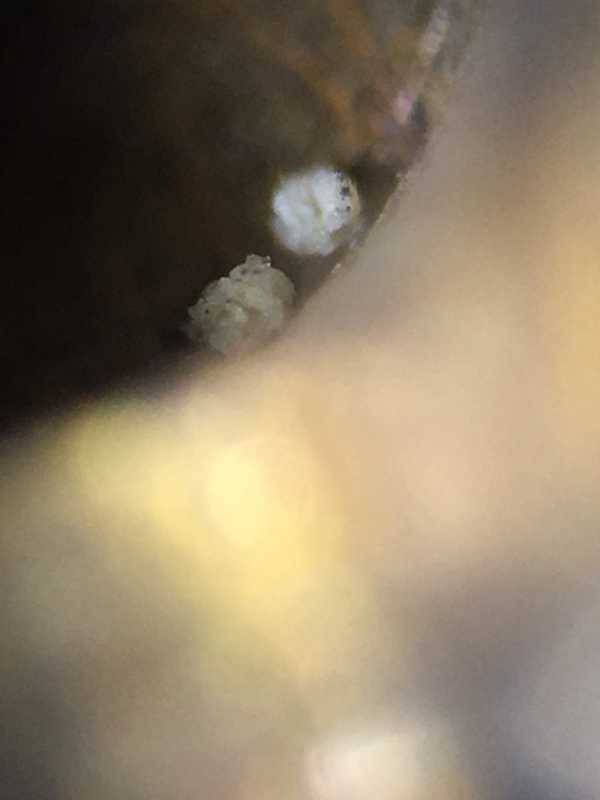

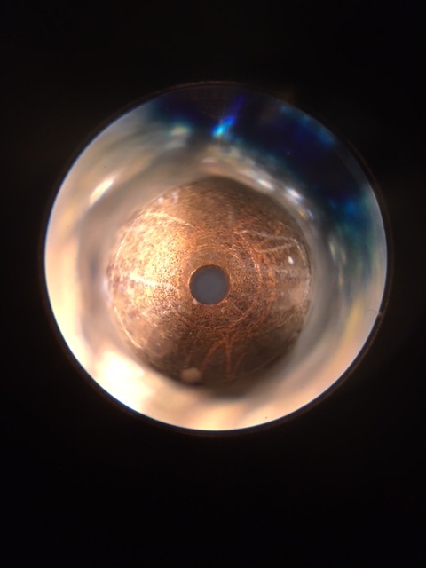

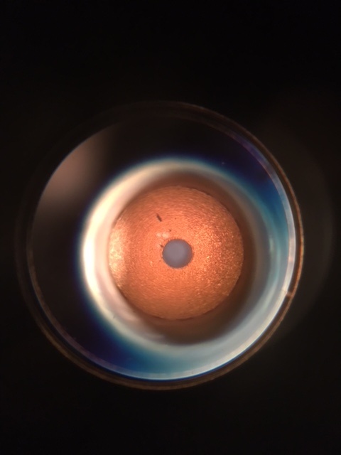

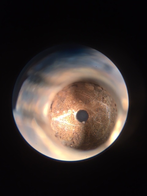

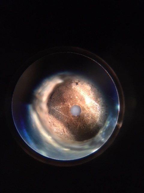

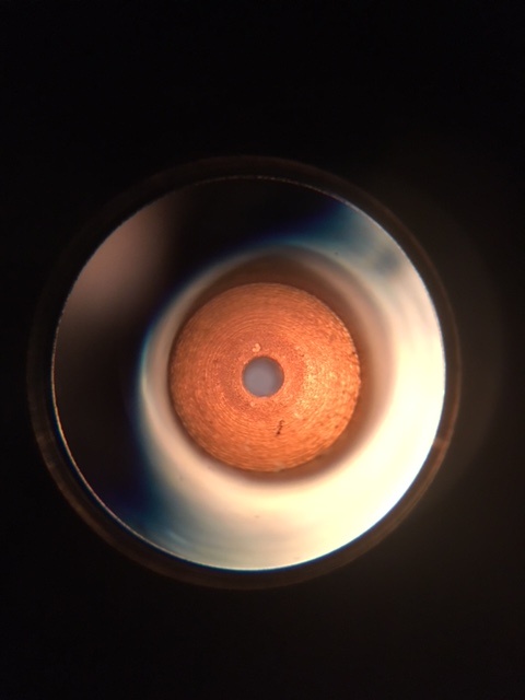

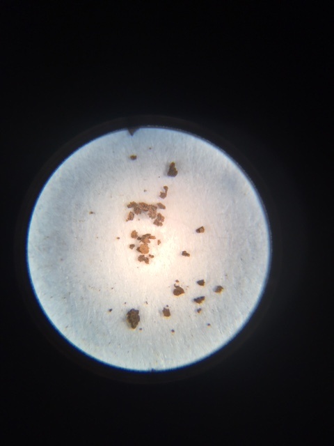

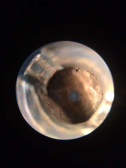

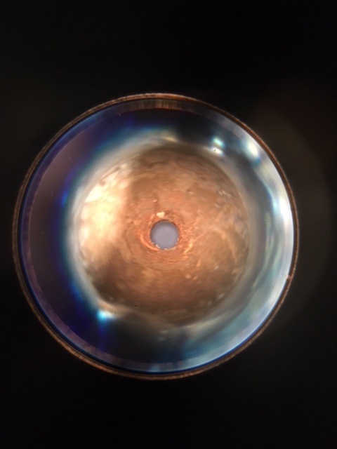

With new idle jets installed, the customers carbs that previously couldn't be tuned are now running my bike like a basket full of happy kittens. Vacuum bench-sync'd along with the usual pre-install adjustments I had merely to adjust the idle-speed and tweak the sync to get a slightly higher HG reading. he'll be very happy, I'm certain.
Put new idle jets in mine before re-installing them. No significant difference other then a slight adjustment to the idle-speed and dialed the idle needles back from 3.5 to 3 on all of them.
The pictures are of the 6 inlet and outlets of my 38 year old original idle-jets. 5 in remarkably good condition. One is badly decayed on both ends. The picture of "the bits and pieces" are what could be loosened with a strait-pin with no scraping from the "bad" jet. Note the last two ! From what I can ascertain from some "reading" :The white specs are due to Ethanol reacting with the brass. ALL jets had some of these white "crystals".
All but the last two - 40X magnification.
Last two - 100X
Last two - 100X

Looks I should say... 'good'???
Great investigative report! The lesson is??
Well, I will clean the shit out of any carbs I get my hands on, and replace these jets. No guessing game.

A good question ! No single answer. I believe it's a combination of the "Fuel" we are now having to use AND.....these are older machines with unknown histories but think it's safe to say "Multiple Owners". Clearly, the fuel is leaving undesirable deposits. Consider however, multiple owners. Not understanding some of the "finer points" that we have now become aware of - such as NOT to Ram a 'tip-cleaner" through the idle-jets and not understanding how to set the carbs correctly. Although the manual gives the basics there is a little more to setting-up these carbs given there age and the inherent wear on the linkages. I've suggested previously that these carbs aren't complex regarding how they work - Carbs are carbs - but they do have a convoluted array of galleries to route the mixing-air and fuel to where it needs to get to. And recently discovered - a "hidden" metering jet that is inaccessible.
Internal cleanliness is at the fore-front of having the Mikunis operate correctly.
The more familiar one is with the workings, the easier it gets to diagnose the problems. (Most of the time) However. the sensitivity of the idle-jets to ANY damage and/or deposits enlightened me.......and I've been dealing with these carbs for myself and others for years.
