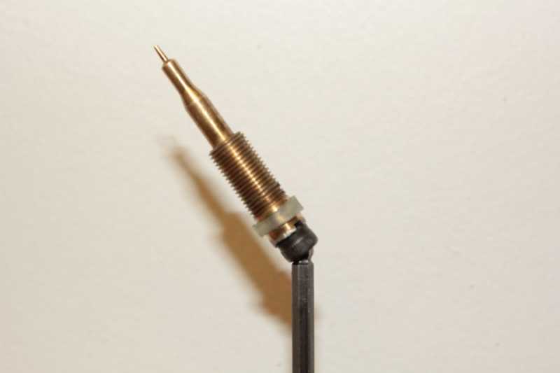

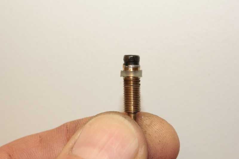

what's supposed to give them some stiction, the spring or the o-ring ?
Both the o-ring and the tension provided by the spring keep the needle in place.
Almost every set of carbs I have rebuilt have had this same issue. The OEM o-rings shrink, despite feeling viable. This included my own several years ago. Subsequently no o-ring resistance and that suggests a poor seal.

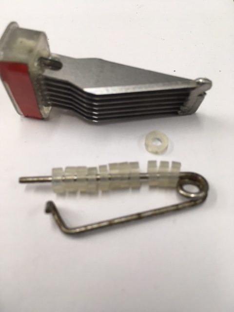

I came up with this solution and it works. Very well ! Small diameter silicone fuel tubing (R/C airplane engines) found at most hobby-shops - generic - ( Stan - note the lack of CAPITAL letters!:woohoo: )
Making them individually was problematic as I could only get 1 to my satisfaction out of every 2-3 cut. Then came up with a "cutter" that makes 6 at a time and all usable !
A "smear" of silicone grease and they turn in easily, seal perfectly and add that needed resistance.
They do not come in contact with fuel ( not supposed to be fuel in this area) so last a long time.
The socket-head conversion to the mix-screws is worth it's weight in gold !

Scotch I like that, silicon tube is a good idea!
Oversize but highly compressible, good thinking.
My box of o-rings doesn't go down to this size anyway, and actually the silicon may be a better way of achieving a very snug fit whilst still allowing rotation, whereas the harder o-ring rubber is much more critical to diameter.
From my R/C days (Stan cover your ears) silicon is fuel proof anyway (or at least for the nitro in those engines) so doubly ideal.
As much as I'm impressed with your mass-production tooling, I'll go the Edward Scissor-hands machete route, given the price of silicon!
Much appreciated.

When I see 'carb' in the title I just click to see, haha
Great info again, and I got to see your automation tool! Nicely done!
- Posts: 2062
- Thanks: 953
Re: Carb reassembly questions
I'll suggest you use a new/sharp box-cutter blade or similar. Scissors create their own problems with this task, but a very small/very sharp machete would certainly add some excitement to the job!
