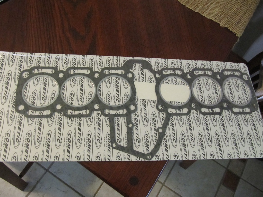

1. I'll back up on my first statement about all OEM head gaskets being 30 years old. In retrospect, it seems silly that Kawasaki would cease part productions immediately after discontinuing the motorcycle itself. Maybe I've been unlucky, but both head gaskets I saw seemed to have a bit of age to them. Speaking of which...
2. Both of my head gaskets were still in the original packaging. On the first one, the sealant actually peeled off the gasket and stuck to the packaging. On my second, the sealant looked very spotty, with air bubbles and gaps in the line. Having spent WAY too much money at this point, and after hearing other confirmed cases of these passages leaking, I erred on the side of caution and gave those passages a bit of help sealing up.
3. That being said, your gasket actually looks really good. The only thing that concerns me is the lack of sealant for the coolant passages on the opposite side- I'm fairly certain mine had the sealant on both sides.
Again, to each his own. To me personally, changing the head gasket was a long, involved process that contained a lot of stuff that a klutz like me could easily screw up, and a lot of expensive, hard-to-find parts. I don't feel like tearing it all apart again because I end up with a minor coolant leak.
(Since I changed mine, I have nearly 1000 miles on the gasket. No leaks from anything that I can see, be it coolant or compression in any cylinder. As always, YMMV.)
My K gasket does have the sealant on both sides, the other pic is the aftermarket one. I'm often sceptical about not using cheap repro parts but in this case being able to compare the 2 I wouldn't fit it on my bike. I have just fitted the cheap carb repair kits but if they fail at all pulling the carbs is easy and expected unlike the head..fingers crossed it all works out.

The factory gasket shown earlier in this thread looks to be in excellent shape. I would not have a problem using that, it is quite common to see the sealant applied to those gaskets delaminating and falling off.
For those that have problems finding an OEM gasket Comitec will cut one for you. If you call them and talk to their custom gasket dept. they have the pattern for a 1300 and will cut a gasket for $79. They can also use larger diameter fire rings for those of us with big bore pistons. This is an excellent quality gasket made form a very good quality base material of the proper thickness.
www.cometic.com/custom-gaskets.aspx
