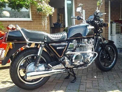

Hi all,
Just bought my first KZ1300, always wanted one of these beasts when I was younger but couldn't afford it back then! registered as 1980 imported into UK 1998, 16000 miles, ran sweet on trial run of about half a mile, now the 2 middle cylinders won't fire up, been on a 15 mile run up to 8 thou revs, still not firing, exhaust pops at times, before I strip the carbs or start checking the coils etc, any help would be much appreciated.
Many thanks
Nigel

Hi and welcome,
That looks very nice. I was in the same boat when I was young too. 20 years ago I bought an A1 (when someone stole my spotless CX650 Eurosport - every cloud...) and a few years later I sold it to buy a B2 Touring.
It's worth bearing in mind that 3 and 4 cylinders share an HT coil and pickup coil as well as a common carb so might be worth checking for a good spark there. The original HT coils have moulded HT lead which can't be replaced and the coils a prone to splitting open under the heat. Pick-up coils fail occasionally too.
I hope it's something simple like a stuck float valve on the centre carb
Yours is either an A1 or A2 (1980 suggests A2) and your pickup housing is behind the block
