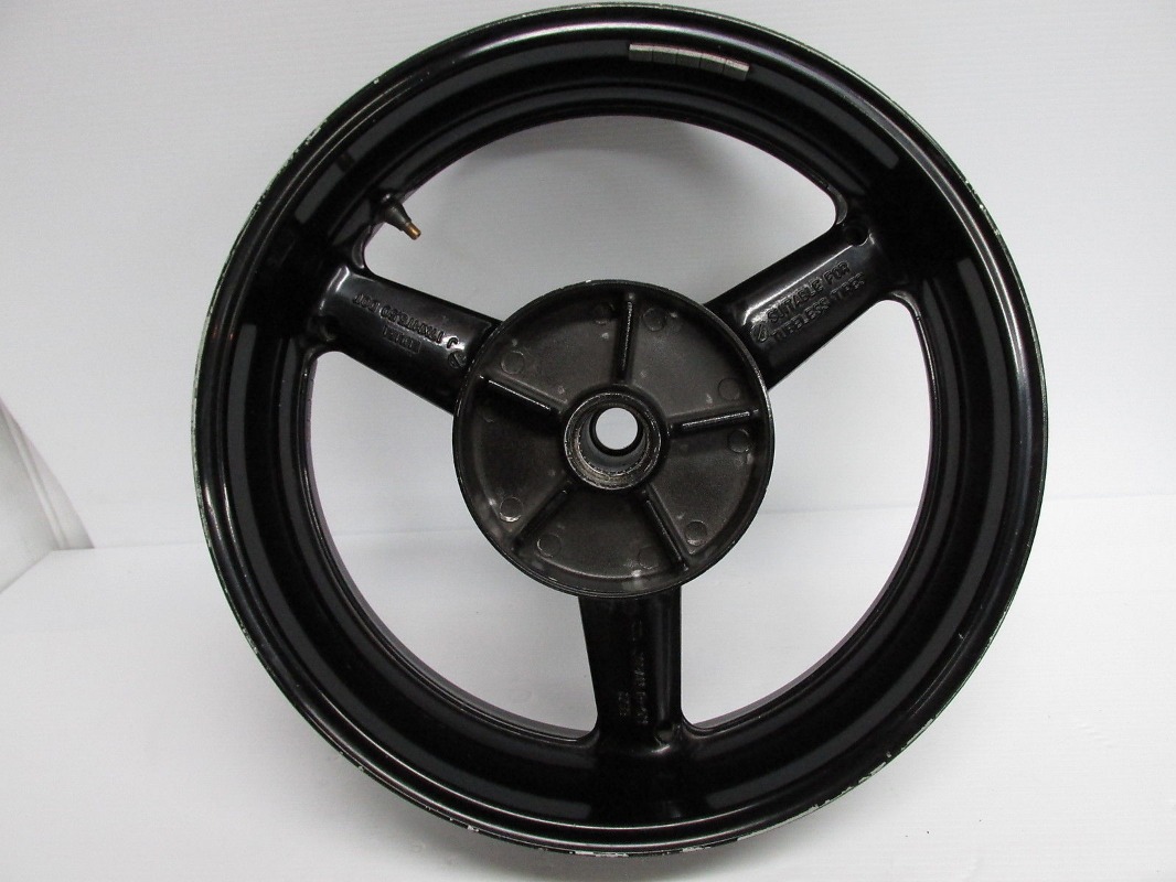

I'm somewhat surprised that I haven't seen anyone adapt a wheel from a different make/model to the drive system on the KZ1300. The drive plate that engages the cushion drive is a 7 lug plate, but I'm sure that with a bit of work, that could be altered to a 5 or 6 lug plate. I'd rather take a chance on the drive plate crapping out before I had a wheel rim fail.
Looking at a 2000 Yamaha R6 wheel hub looks a lot like the KZ wheel hub. 17 X 5.5 would allow a 190 tire. That would look nice and fat on the back end of the 13
