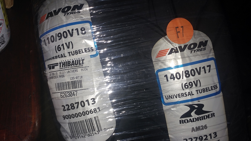

Hi Daro,
Same thing happened to me with the 'pumpkin'! What a mess indeed if you don't catch it in time...
I used Avon tires. I asked in multiple clubs on facebook about tire choices, and there were two prominent runners up: Avon Roadrider and Bridgestone Battlax. I went with Avon.

Yeah Stan, thanks for the tire info. Today if you want to buy something, there are so many options on the marked available that often you just cant decide. Any ways i thing Avon is a good option apart of the Michelin tires and they are both from the same price sector, i got few days to decide so ill read a bit and see.

The too many option is a curse to me, haha Not just tires, pretty much everything you touch. I couldn't count how many times I went shopping and ended up just leaving the store frustrated and empty handed. Often because they have a wall of shelves full of products with very confusing meaningless names and I can't find what I am looking for - a simple straight forward solution!
With tires I spent quite a long time trying to pin point what to decide on. Lots of reviews reading. It was important to me to hear that the tires were good in wet conditions. I also prefer the front and rear tire to have the same thread patters, so best is they are the same model. I also never want to increase the wall height, and if looking for alternative size, I stay with the same rim size and try not to change the new tire speeds too much (stay as close to the original diameter as much as I can). The speeds - the suggested V rating can be replaced with H no problem. There is no problem bringing the bike up to the V rated speeds for a very short time, and that's all we usually do. Unless someone want to be on Germany's autobahn at top speeds for hours, or racing. Other than that, H rating is perfectly OK. Same weigh ratings - they can be a bit lower as in real life the rated weight doesn't sit right on that tire but is divided through the frame. I often read what motorcycle people use with certain tires, that confirms there is no problem.
Here is a tire size calculator with speed and mileage changes. Very interesting read especially doing the side by side comparisons.
>>>>> www.tacomaworld.com/tirecalc
Let me know what you end up with!
