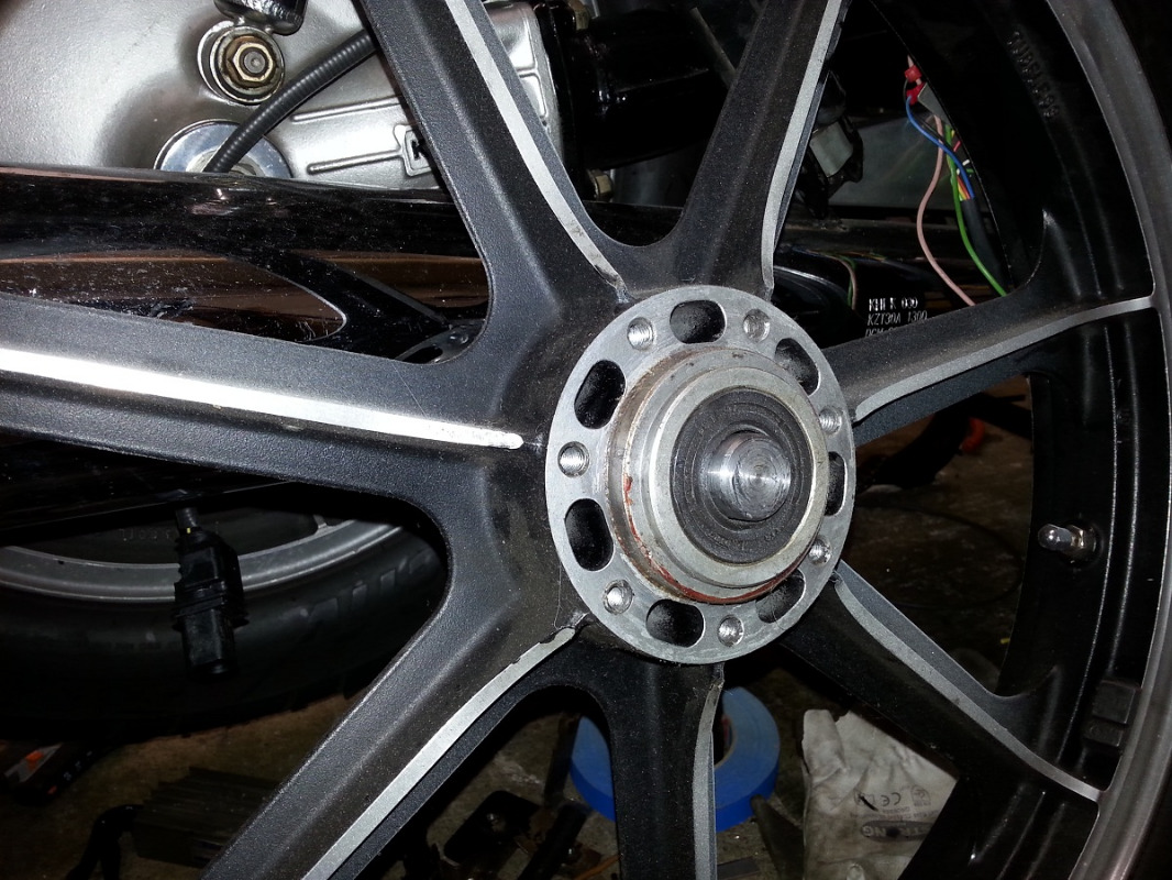

Which blind bearing pullers do you use for wheels?
Re: Blind bearing puller
7 years 10 months ago

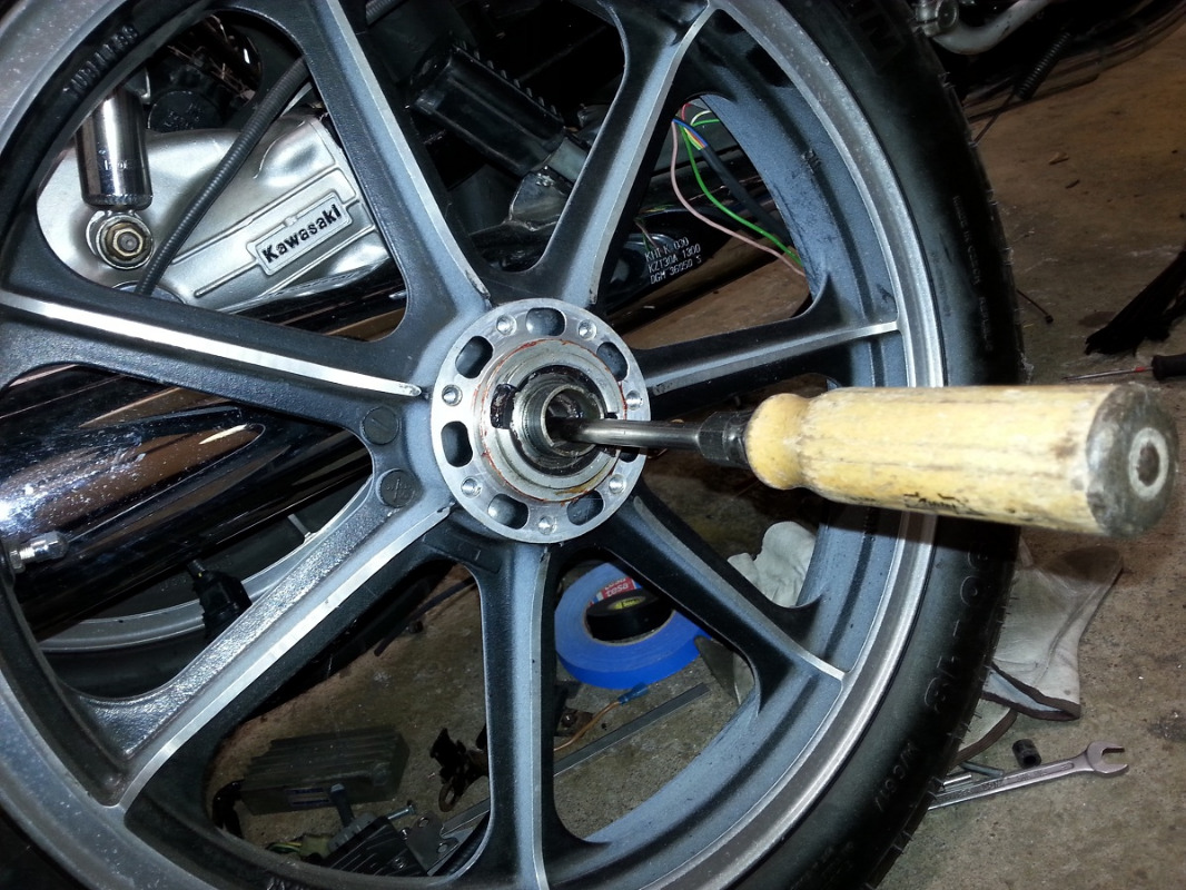

I've always had to knock them out with a punch from the opposite side. They'll have to be replaced after that of course. If there's a spacer between the bearings it's just about impossible to use a puller.

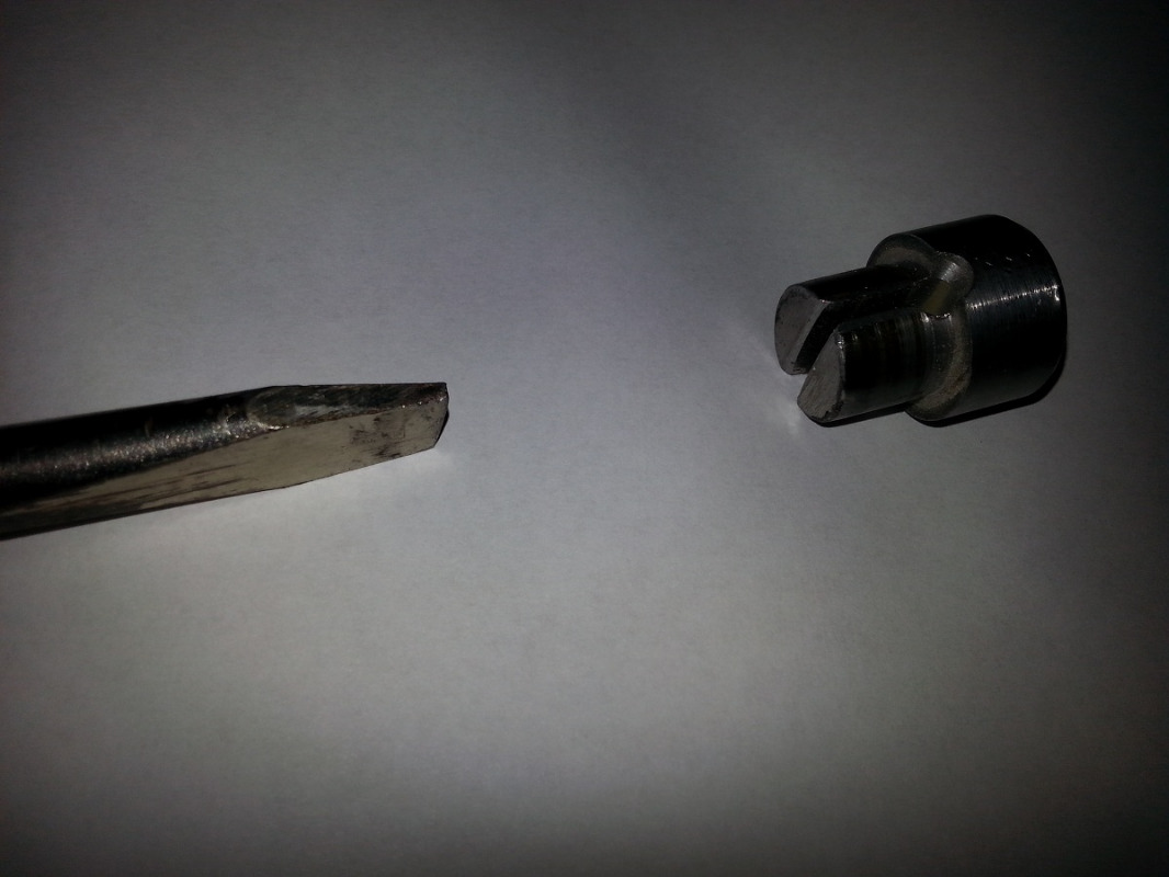

There are similar available in the USA, but I still have to find the one I will like, to eventually buy. At the moment I just paid 20 bucks to have a shop remove one bearing. The punch didn't work unfortunately. (it was a Goldwing not KZ; I don't get why the spacer inside with all the free space isn't 'floating' easy to move out of the way but rather stuck solid between the bearings)

SO, I was more about a real manufactured tool. Those extractors were about CAN$ 10 each. Than 'punch' is very expensive in comparison, and I am regretting buying it, but what the hell. It can be replaced with a long ground chisel or a screw driver.
