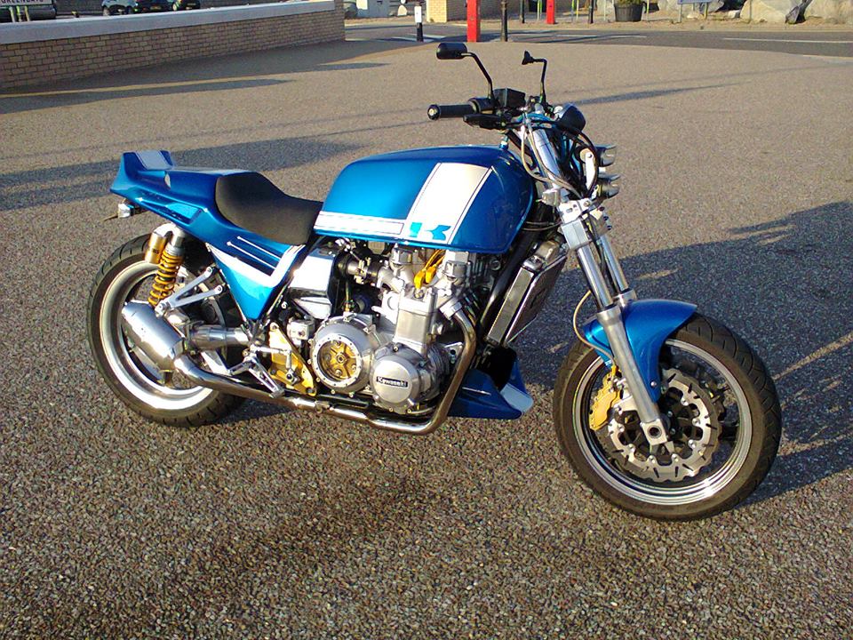

I might be able get my hands on an early KZ13 without front end. Leaning towards a Cafe style anyway. What upgraded front ends have you Guys used on your 13's ?

I have not done anything yet, but am planning to.....I'm looking at upside down gold-coloured Öhlins gas shocks with Brembo brakes, but the more I think about it, the more questions I have as obviously all the measurements will be different, the length and headstock pins will be different, and so the stance of the bike will be affected. triple-tree is different so I may have to fashion that myself. Then there is also the question of finding shocks that can 'withstand' the weight of the KZ... anyway, lots of things to think about.

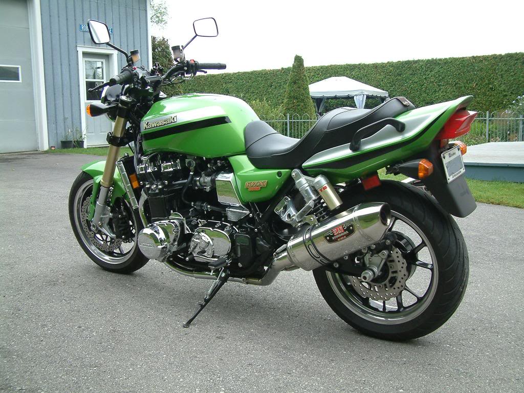

I would think the front end from either the Hya or the ZX14 would be fine. Might have to change out the spring but the weight difference is only 45 kg's which is shared front and rear so weight on the front end difference maybe 30 kg's? And a little more air in the front can make a big difference
Then there's Robert Bolduc's ZRX1200R with a KZ1300 transplant. Drop dead georgeous !!
That is so good looking
