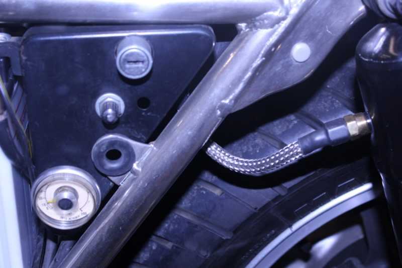

Hmmm. A noticeable abscence of comments here....which could be speaking volumes. I put some S&W air-shocks on within first 2 yrs after the stock shocks could no longer carry 2 and some gear without bottoming-out. With such a small air-volume capacity the problem with the S&W's is they are either too hard or too soft. This winter I added a "volumne-bottle" to see if the additional capacity will translate into a more compliant ride. At least another 6-8 weeks before insurance, to see if the idea works !
