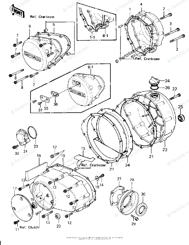

2024-01-20 Oil SeepageWhat's behind this cover? Anything going to spring out?
Partzilla doesn't show a gasket for it...

Item #33  -  45mm o ring behind the timing shaft cover (which is the access for removing the timing shaft sprocket). Just crankcase pressure .if you have to remove the tensioners do so very carefully and don't move the crankshaft until the tensioners are back in and confirm the camshaft timing before turning over the engine.

"Engine Covers" department.   O-Ring ordered. eBay.
