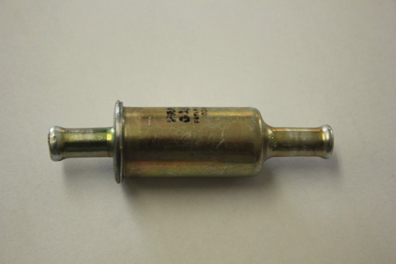

After rebuilding I configured two sets of cabs like this, for a 1300 owner
 WIX # 33027  used these for years.  Don't let it's size fool you.

The following user(s) said Thank You: dcarver220b, zed_thirteen, Ted
